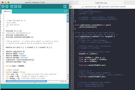

Step 10: The Software
This was the most challenging part of the project for me. With the help of some friends at Pier 9, and a lot of time doing research online, and sketching diagrams in my notebook, I was able to figure out the trigonometry formulas I needed in order to calculate what angle the mirror needs to turn at to redirect the light to a particular spot on the wall.
Attached is the Arduino application that runs the motors to direct the reflected light to spell out different words. Also attached is the custom library called LightLetter, which is an abstract representation for each letter. This is where all the trigonometry calculations for figuring out what angle to rotate the letters at happens.
In the end, I came up with a pretty robust system, that basically let's me enter any words or phrase into the software, and all the logic and formulas for what angle to spin the motors at happens internally. At the moment there are a few different modes that the software can be set to. A SWEEP more basically moves all the letters back and forth across the wall slowly, this is very useful for calibration. A DEFINED mode displays a particular sequence of words in the order that I define. A RANDOM mode randomly picks words from a pre-defined list.
