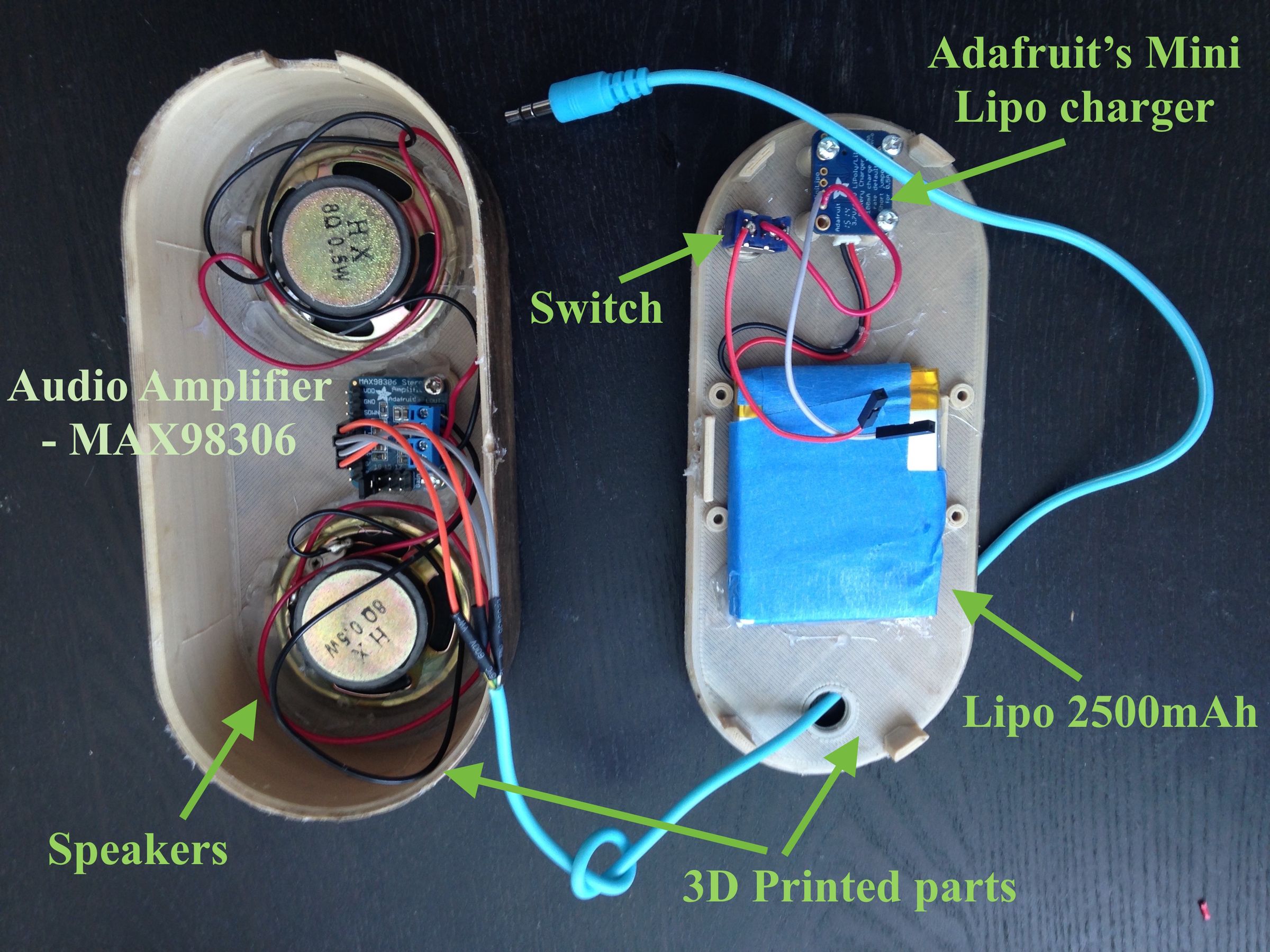

Step 4: Soldering and Add the Electronic Components to the Base
It is now time to take a break from sanding and solder the electronic components together, so fire up your soldering iron..
Start by soldering bread-boarding wire to the speaker terminals
Cut off one end of of female to female jumper and then solder to GND pin on Adafruit Mini Lipo w/Mini-B USB Jack. Then connect the BAT pin to one end of the switch using using bread boarding wire and the other end to female jumper wire.
Now cut the end of your audio cable and connect 2 female jumper wires to the white line and one wire to Left side and the other to the right side.
And then connect negative wire from the Mini Lipo w/Mini-B USB Jack to GND and the positive wire to VDD, as shown in the picture above.
For more info and to solder pins to the Class D amplifier refer to guide on the Adafruits learning system, Here remember to solder the pins in the opposite direction, compared to what is shown in the guide for easy mounting on the 3D printed part.
https://learn.adafruit.com/stereo-3-7w-class-d-aud...
Once you are done with the connections, screw down the speaker in the blue terminal blocks
Now connect the lipo battery and turn on the speakers and connect the audio jack to the phone to test it out..
Also test that your lipo is charging and wait for the lipo to completely charge.

Step 7: Add the Electonics and Glue the Parts Together
Now add the speak guards to the 3D printed part and then hot glue the speaker to the base part as shown in the picture above.
Add the switch and hot glue the battery to the base part, also add tape to the battery to safe guard the battery.
Now screw the Adafruit Mini Lipo w/Mini-B USB Jack to the top 3D printed part as shown in the picture above, using 4-40X3/4 screws.
Add the screw the amplifier to the base 3D printed part.
Now flip the switch and test your circuit before
