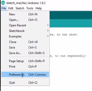

Step 4: Open Arduino
1::open Arduino software
2::Go to File > Preferences
3::Paste this link >> http://arduino.esp8266.com/stable/package_esp8266...
to the Additional Boards Manager URLs then hit ENTER(as shown in 1st & 2nd Image of this step).
4::Go to Tools > Board > Boards Manager
5::Search ESP8266 & DOWNLOAD INSTALL VERSION 2.0.0(as shown in 3nd & 4th image of this step).
6::NOW again Go to File > Preferences Open the folder path below More preferences can be edited directly in the file.(as shown in image no.5th of this step)
7::Then copy this file name & search ( user_interface.h ) open this file with Notepad++ (as shown in image 6th image of this step)
8::Copy these 4 lines & paste it inside file as shown in image 7th
