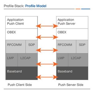

Android Phone runs a bluetooth protocol stack. Raspbian OS, the popular OS for Raspberry Pi also runs an implementation of the Bluetooth protocol stack. This suggest that the Raspberry Pi and the Android Phone are able to communicate remotely using Bluetooth Object Push protocol as depicted in the first picture. However, for these 2 devices to do useful task, a Bluetooth profile must be defined and implemented for each device. A useful Bluetooth profile for these 2 devices to have is the Object Push Profile (OPP).
Android OS has a built-in OPP client. In order for Android's OPP client to communicate with Raspberry Pi, we must make Raspberry Pi become a OPP server. This interaction is depicted in the second diagram.
This instructable will demonstrate my attempt to make Raspberry Pi and a notebook computer become a OPP server so that a device like an Android Phone can communicate with it remotely.
