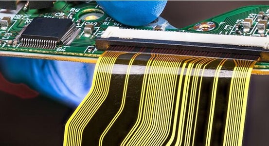

Check Here for Rigid-flex Pcbs with this your circuit becomes flexible! I have added the images to this step kindly check.
A revolutionary solution that combines the best of both rigid and flexible circuitry to elevate your electronic projects to new heights.
With their expertise in advanced manufacturing techniques, they offer a seamless integration of rigid and flexible components, ensuring enhanced reliability, durability, and space-saving benefits

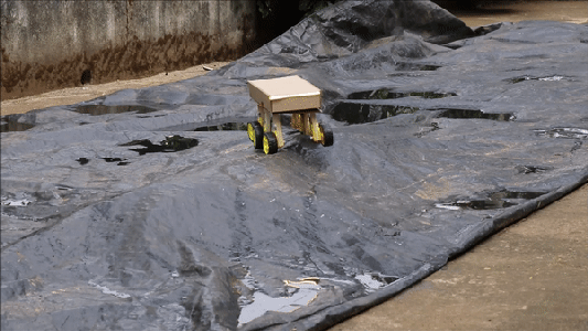

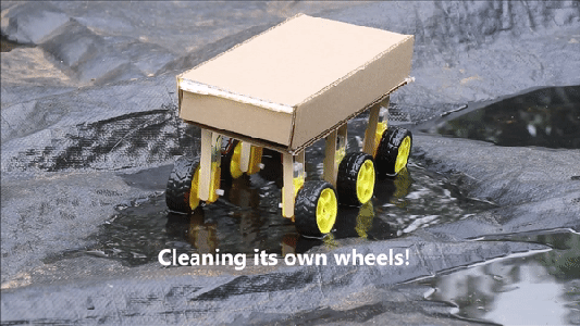

Step 7: Testing the Robot Car
This is the most interesting part of any project, Watching your creation work.
This is the best feeling ever and in my project this robotic car has 6wd meaning all the 6 wheels are responsible for movement, I have tested this robotic car on a few terrains! and the results were just amazing.
It can easily pass across small humps and obstacles.
No need to worry about the battery backup, Those 18650 batteries are very good at keeping up the charge in a long run.
When you are done finishing up the battery, all you have to do is pull up the cover and remove batteries, Recharge them, and there you go, you can start to explore the places around you!
