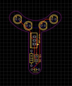

Step 2: Heat Sensor Circuit Design
The Design of heat sensor circuit along with the PCB layout can be seen above. Power supply don’t included with the circuit. You can use any 12 battery for this project.
Step 3: Schematic of Heat Sensor Circuit
The schematic of heat sensor circuit along with the PCB layout can be seen above.

Step 7: Connect LED With PCB
To make this circuit, we need to make a series connection in these 4 led lights. Here series connection means, we connect one LED negative leg with another LED positive leg.
In this way, we will get two different terminals. One is negative and the other one is positive.
Step 8: Connect Resistor and Mosfet With PCBS
We are using 2.2 KΩ resistor IRF z44n mosfet. We connect resistor with “Gate” and “Drain” leg of mosfet. Then we connect LED with mosfet.
We connect this LED negative leg with “Drain” leg of mosfet.

Neat and perfect soldering is an important part for all kind of PCBs. Since soldering, you should remember that, there should not be any kind of short circuit connection. After soldering all leg, we cut-off the extra leg of all electronics component.
We also can use liquid PCB cleaner to clean the PCB board.
