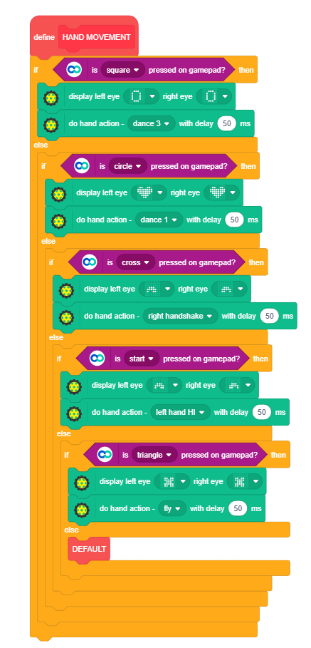

Step 14: Graphical Code to Control Your Robot
Coding the bipedal humanoid robot has never been this easy. Secret? PictoBlox. We will code the bipedal in PictoBlox- a graphical programming software. Where we can just drag and drop the blocks and the code is ready.
The best part? We can calibrate the servos in real time. The following are the two dedicated blocks:
  • To calibrate the Leg Servos( move left leg () right leg () left foot () right foot () in () ms ):
  • To calibrate the Shoulders( move left shoulder () right shoulder () left hand () right hand () in () ms ):

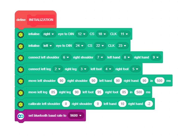

Before we start working with the bipedal, the first thing we need to do is upload the firmware. Upload the following code to upload the firmware:
Once everything is done, let’s begin to write the code:
The first block is none other than the main block, which will call out all the functions:
Now, we need to first initialize all the servos, every time the bipedal is powered up. This block brings all the servos to the original position.

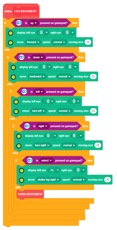

The next block is the Leg Movement block which will make the robot move according to the key pressed in Gamepad.
The Hand Movement block, allows us to control the hand movements of the bipedal according to us.

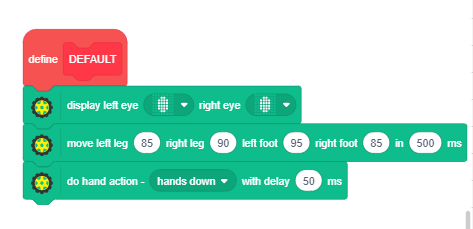

Lastly, the default block. Whenever no key is pressed the robot follows the Default code.
