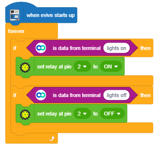

Step 7: Writing the Graphical Code and the Logic
To make the project simpler. We are going to code it in PictoBlox- a scratch based graphical programming language, where we need to just drag and drop a few blocks to create a complete script.
Before writing the code let's first understand how will our system work.
We are going to use the terminal module of Dabble to send the data to evive. Thus, dabble terminal block needs to be used in the code.
Now, as soon as we write or speak "lights on" the bulb will glow, as we will set the signal pin of the relay "ON" which in turn will close the circuit. Turning the bulb ON.
Similarly, on receiving "lights off", the signal pin of the relay will be set to "OFF" and the bulb will turn OFF.
Write the following script and upload it to your hardware. Or download the code given below:
If you want to display the status of the bulb on the evive TFT display: upload the following code
