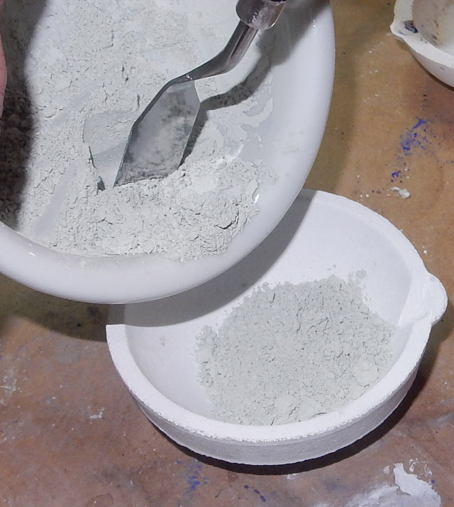

Now that you have well ground mixed metal oxides, you need a crucible that is clean or has only been used for YInMn blue making. Crucibles used previously for making the pigment can be cleaned up a bit by rubbing the interior with a dry paper towel and removing any powder that loosens. If the crucible has been previously used only for making YInMn blue with the same concentration of manganese, cleaning is optional. Carefully transfer the ground powder into the crucible. As you might expect, having a new clean piece of paper underneath to catch spills helps here too. Use a transfer tool to scrape off the oxide mix sticking to the bottom and sides of the mortar. When you have gotten off as much as you can by scraping, take a new clean paper towel, bunch it up and lightly rub the bottom and sides of the mortar. Some of the oxides will stick to the paper towel, but more will collect as powder and can be transferred to the crucible.
Using the flat end of the pestle that is normally held, tamp down the powder in the crucible. Lightly at first, as otherwise the powder will fly everywhere. Once partially tamped down, you can do this harder. It is difficult to know how much tamping is enough, but my experience suggests that when tamping in one place starts to break up or move tamped powder that is close to where the tamping is being done, you have done all you can do. Further tamping will not help with the reaction. You would need a pellet press to do more, and those can cost as much or more than your furnace.
Place the crucible into your furnace. Don't let the crucible touch the heating wire, but if running several crucibles, the crucibles can touch each other. If you have lids they can be used, but are not necessary unless you are trying to really pack the furnace and want to out a small crucible on top of a flat lid of a larger crucible. I've done it, this works just fine. Once your furnace is packed, close it, turn on main power and set the temperature for 1200°C (about 2200°F), Do not go lower. You will not get YInMn blue. You will get a paler, greyer blue down to about 1000°C and little or color change much below that. Let the furnace heat up, start the timer when it reaches 1200°C. Run 6 or more hours at 1200°C. Then turn off heat, or set the temperature on the furnace to below room temperature (I use anything under 10°C). And let it cool to room temperature. I like to set the temperature to below room temperature so that the PID controller on the furnace continues to report the temperature in the furnace.
When you open the furnace, your once grey oxide powder mix should be blue. A paler, less vivid blue than the final pigment, but it should be blue. If it isn't blue, either the temperature was not high enough, or one or more of the metal oxides was either not pure enough, was contaminated before reaching you or contaminated during your preparation. This is why the papers to catch spills were always new and clean. If there was contamination, the mix will likely be brownish, while if the temperature was simply too low, the powder will be an unchanged grey or a grey-blue without any hint of a brown tone.
The now blue heated oxide mix (called the pigment from here on) should be transferred to the cleaned mortar and pestle. It will be lightly sintered together. Running a thin tool between the pigment and the wall of the crucible may dislodge is all at once. Or you may need to use the tool to carefully break up chunks of the pigment, hopefully done without breaking the crucible. Once in the mortar, use the pestle to crush the chunks. You will see small white or pinkish white flecks inside the mass of pigment. The better you ground the pigment in the prior step the fewer and smaller they will be.
Grind the pigment up paying special attention to crushing and grinding as many of the flecks as possible. The flecks will be much harder than the rest of the pigment. Really grind them hard. When you have done as much as you think you can, try to grind a little more, then transfer it back to the crucible it was prepared in. Tamp the powder down again, reload the furnace and heat again just as before to 1200°C for 6 or more hours. Let the furnace cool. Then transfer the reheated pigment back to the mortar. Crush the pigment up again. You should see fewer, smaller flecks and the pigment will likely appear more vividly blue.
Regrind the pigment, again paying special attention to the flecks. Grind them down as much as you can. If you did a very thorough job with the initial grind of the oxide mix, there may be only a few flecks. If you did not grind well at this step you will be doing a lot more work here. Once again, grind them down as much as you can, transfer back to the crucible, tamp the powder down, and heat to 1200°C for 6 or more hours again. Let the furnace cool. The pigment should be a vibrant, brilliant blue under strong light and crushing it in the mortar and pestle should reveal no or at most rare tiny flecks visible only with a magnifying lens. Keep grinding your pigment. This time because well ground pigments work best for paint and pretty much any other use. Put your pigment in a clean, labeled container to store it. You can show it off and explain how you made the famous, but infamously hard to find, YInMn blue with just a little solid state chemistry. Mix it with a little watercolor medium or acrylic dispersant as a part of paintmaking or water and mull it together and you can learn about another aspect of chemistry: non-newtonian fluids. The pigment can be more productively used to make many types of paint as well as to color castable resins.
