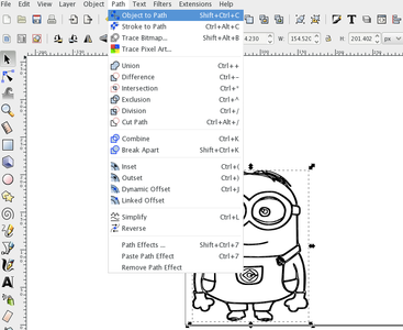

To convert your image into a vector graphic, first select your image, go to "path", and then select "Trace Bitmap". This will then open a new window. In this window you must select edge detection in order for the extension to work. You may also select "Live Preview", in the bottom right corner, so that you may see what your image will be converted into. Once you have selected OK and converted the image, the new vector you have created will be placed directly above the original image. you can now drag this off of it, delete the raster image, and take your new vector and place it where you would like it to be drawn.
Step 7: Convert Your Vector Image Into G-Code
The first thing that you want to do is select your vector image, go to "Path", and then select "Object to Path". Now it comes to finally getting to use the extension. Go to "Extensions", select "Generate GCode", and then go to "J Tech Photonics Laser Tool..." A new window will pop up. In this window you will have to modify both the "Laser ON Command", and the "Laser OFF Command". We will want this so that it raises our pen up and down as it is attached to the 3D Printer, allowing it to either be drawing or not. All that you have to do is make the on command say "G1 Z0 F5000" and have the off command saying "G1 Z2 F5000". After that you will have to enter in the directory. This will be where your G-Code file will be stored. Once you are done, you can click on "Apply", and it will then generate the G-Code needed to draw the image using your 3D Printer. When the extension is done processing, it will then show you your image made up of arrows directing the path.
