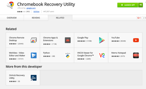

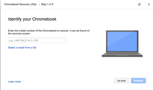

Step 3: For Windows Users

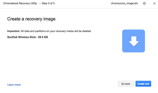

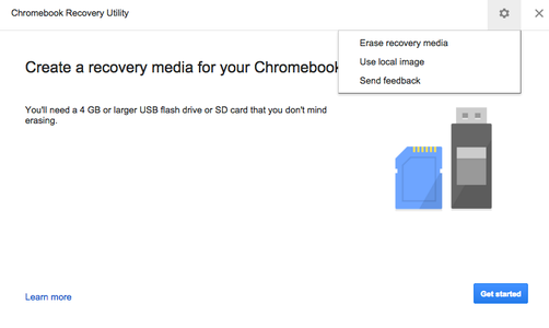

Now that you have the OS downloaded, go ahead and click this link. This will lead you the chrome app store. Download the Chromebook recovery utility. This is a certified google product. Open Chromebook Recovery Utility and click the gear icon on the top right. Click "use local image" and select the file you just downloaded from neverware. It should be called "cloudready-free-46.1.20.zip" and should be found in your download folder. Click next, and select your flash drive. Click Install, and the program will install. The file can take between 10-25 minutes. Once the install has been completed skip to step 4.

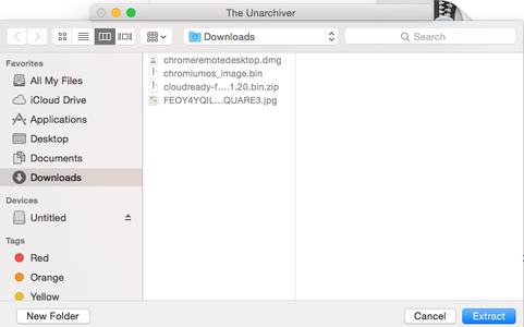

Step 4: For Mac Users

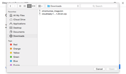

The way you have to install the file onto the flash drive is similar to the windows, but with one small extra step. You are going to have to install two applications. They both are certified and safe. Install The Unarchiver is here, and Chromebook Recovery Utility. Go to the file you had originally downloaded. It should be called "cloudready-free-46.1.20.bin.zip." click that file with two fingers, opening up a menu, and select open with... Unarchiver. The Unarchiver will open itself up and ask where you want the destination will be. The downloads folder should already be selected, so just hit continue and the program will go to work. This should take about 5-10 minutes. Once the file is done transcripting, (program will say so) you can close out of the Unarchiver. (You may delete this program if you wish). Now you are going to do exactly what windows users are doing.
Open Chromebook Recovery Utility and select the file. It should be called "cloudready-free-46.1.20.zip" (make sure its called "cloudready-free-46.1.20.bin" and not "cloudready-free-46.1.20.bin.zip" (the differance is the zip). This file should be found in your download folder. Click next, and select your flash drive. Click Install, and the program will install. The file can take between 10-25 minutes.

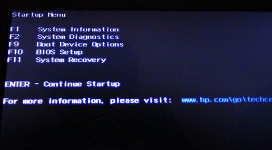

Step 5: Booting Your Computer in USB
You now have to Boot the old computer in USB mode. To do this, first, completely turn off the computer. Plug in the flash drive into the old computer. You will have to go into startup options. This varies from computer manufacturers but the below should help.
Most Dell models: Tap F12 when the Dell logo is displayed.
Most HP models: Tap F9 when the HP logo is displayed.
Most Lenovo models: Tap F12 when the Lenovo logo is displayed.
Most Apple Mac models: Hold the Option key when the computer first turns on.
If none of these work hit esc (top right of your keyboard)
Hit the corresponding key the selection you want which to "Boot device options."

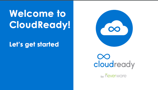

Once you have all that squared away, select the flash drive (using arrow keys and enter) and let the OS boot. Congrats, You have successfully run chromium OS on your old computer. Follow the onscreen instructions to sign in with your gmail account. You computer should be able to do easy ask like it used to.
However this isn't permanent because the OS only exists on the flash drive, not the computer. To officially install the OS on the computer, or dual boot, go to the next step.

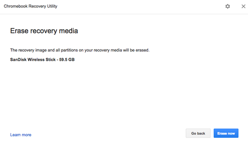

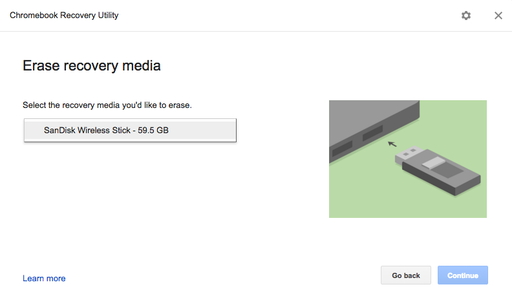

Step 9: To Format Your Flash Drive
You may have realized when you plug your flash drive into a different computer to use it, it may not show up in you file explorer. You are going to have to wipe your flash drive again, deleting the install files. But before you do anything, take out and plug the USB back in. A window may pop up prompting you, saying it cant read the flash drive, and giving you an option to format (erase) your drive. Select that, and you should be fine.

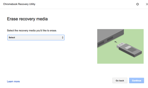

Another options would to open up the chrome recover utility again, and once again click that gear icon. But this time, select "erase recovery media." now just click that blue button and you should be fine.
