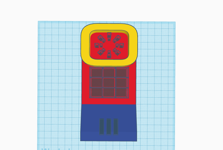

Open Tinkercad and add a cube. Make it 4mm tall and slightly larger than your numberpad measurements. Use ‘hole cubes to create a grid of nine holes where your numbers would be.
Now, have a look through the shapes available on Tinkercad (there are very many). Find the ones that are best suited to create your mouthpiece and earpiece. I used a ‘wedge’ for the mouthpiece and a ‘soft box’ for the earpiece but you can experiment with other shapes until you are happy.
Scale the shapes up to fit the numberpad and case front – remember that the front and back of the case needs to be larger than the hole for the phone – don’t worry if it isn’t the right size we can scale it later.
Add holes to the earpiece and mouthpiece, I used ‘circle array’ for my earpiece.
Once you are happy with your look group all the objects together and export.

Create a flat shape the same size as the front piece. You can do this by copying the front, ungrouping it and removing the ‘hole pieces, then flatten off the top.
Make the back piece 2mm taller than your phone thickness measurement and use a hole piece to cut the shape of your phone out of the back. Leave a 2mm border on all sides except the top and 2mm on the base.
Now export your back and you are ready to slice and print.
