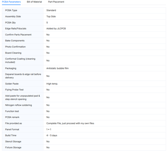

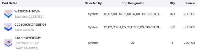

With JLCPCB’s PCB assembly service, I simply:
  1. Uploaded my Gerber files
  2. Selected 2 layers
  3. Chose black PCB
  4. Enabled assembly
  5. Updated the BOM and placement file
  6. Refer to the last two images above to select the appropriate manufacturing options
And right there - price, part availability, and delivery time.
