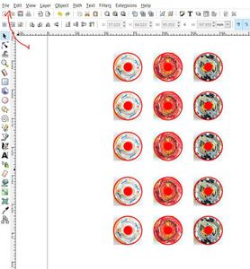

I am using Inkscape in this Instructable but, feel free to use your favorite editing software. On the page draw a circle and resize it to 25.4mm x 25.4mm. Make sure to turn the fill option off. Change the outline of the circle to red. The red will signify where to cut the blade. Next, make another circle. Turn on the fill option this time and change it to red. Resize the second circle to 7.3mm x 7.3mm. This will be used to mark where the gear is to be attached. Import your first Beyblade image. Resize the image to 25.4mm x 25.4mm. If your image disappears use the Zoom Out option on the lower right of the screen to locate it. Copy and paste both circles. Select the copies and the Beyblade image and then center align them. Group all three items together to form the first cutout. Do this for each of the Beyblades you wish to make. You may want to make multiple copies of the cutouts for backups. Align the objects, save the document as a PDF and then print it out on normal copy paper.

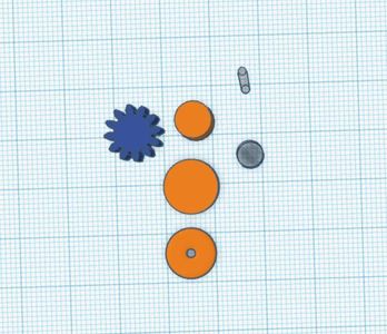

Create a new design and gather the following shapes:
Note: All measurements are in millimeters.

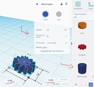

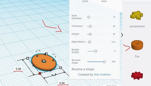

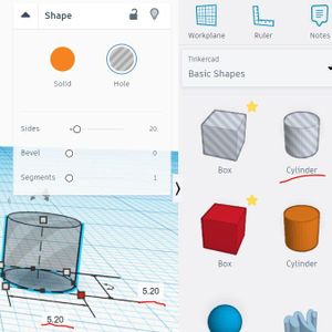

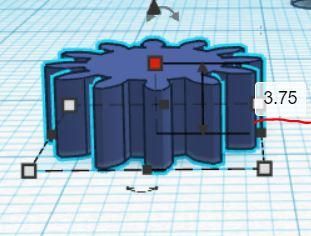

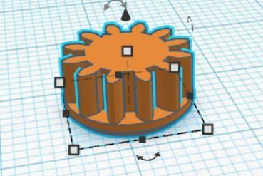

  • Metric Gear: Height 3.75, width 10.89, length 10.89, and teeth count 12. Found under Shape Generator -> All -> Page 3 (See picture 4 for setting details).

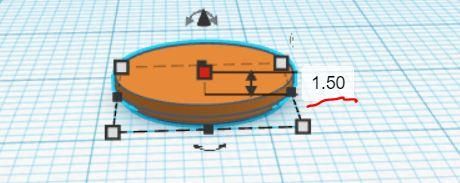

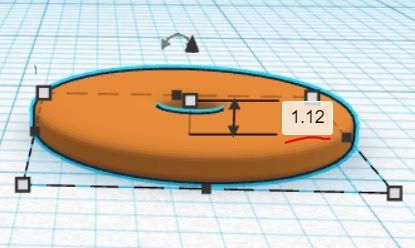

  • Tire: Height 1.12, width 9.96, and length 9.96. Found under Shape Generator -> All -> Page 3.

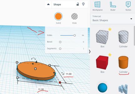

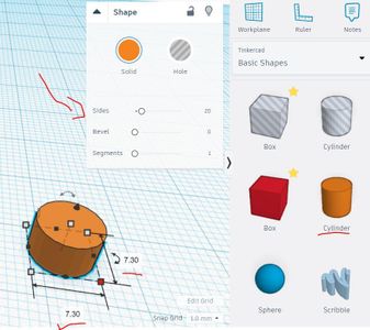

  • Cylinder: Height 0.75, width 11, and length 11.

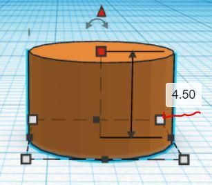

  • Cylinder: Height 4.5, width 7.3, and length 7.3.

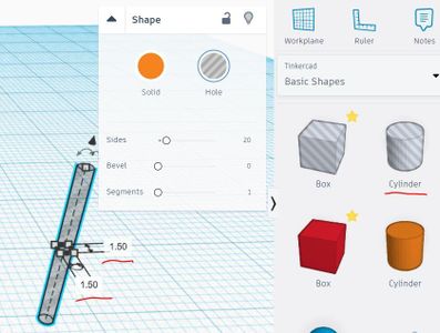

  • Cylinder Hole: Height 20, width 1.5, length 1.5.
  • Cylinder Hole: Height 5, width 5.2, and length 5.2.

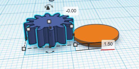

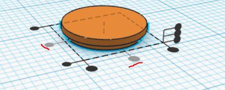

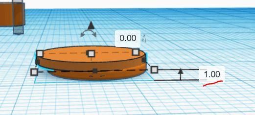

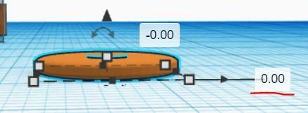

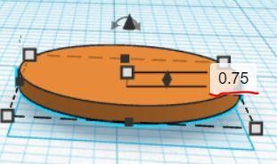

Take the tire shape and make sure it's on the floor of the Workplane. You can check this by clicking and dragging the black cone handle above the selected tire. If both the measurement boxes show 0.00 the object is on the floor of the Workplane. Bring the cylinder that is .075mm tall over to the tire. Raise the cylinder 1mm above the floor using the cone handle. Select both the cylinder and tire and center them with each other. You can center shapes using the Align option on the topmost ribbon(see picture 18).
Note: you can select both shapes by holding Shift and then clicking on each of the objects.

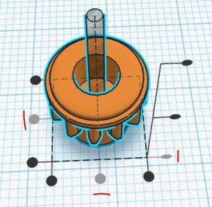

Group both the tire and cylinder together. Resize this new shape to have a height of 1.5mm. You can do this by using to topmost white square handle.
Note: You can group selected shapes together by pressing the keys Ctrl and G at the same time. To ungroup a shape hold down Shift, Ctrl, and G at the same time.

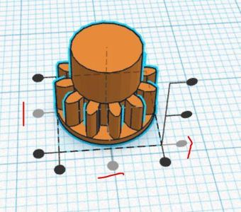

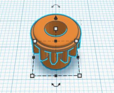

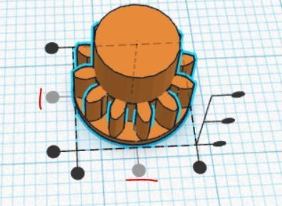

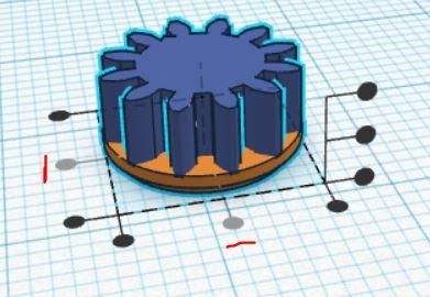

Bring the metric gear over to your new shape. Raise the gear 1.5mm off the floor and center it with the shape you just made. Group these together to form the top of your micro Beyblade gear.

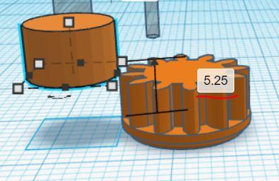

Bring the cylinder with a height of 4.5mm over to the Beyblade gear. Raise this cylinder 5.25mm off the floor. Center the cylinder with the Beyblade gear and group them together.

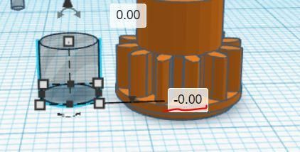

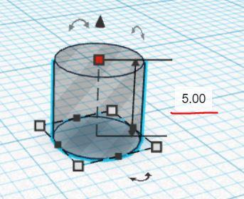

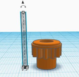

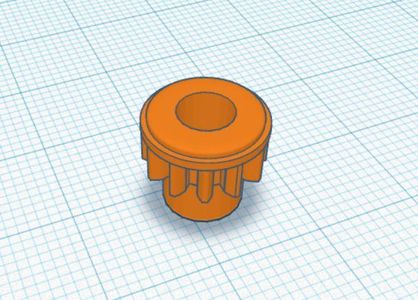

Grab the cylinder hole shape with the height of 5mm and bring it over. Make sure the cylinder hole is on the floor. Center the Beyblade gear with the cylinder hole and group them together.

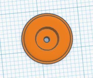

Rotate the Beyblade gear 180 degrees using the curved arrows handle. Bring the remaining cylinder hole over. Make sure this shape is also on the floor. Center the cylinder hole with the Beyblade gear and group it together.
Congratulations you made your very own Beyblade Micros Gear!
Now you need to print your Beyblade gear. If you have a printer make sure to set the print job to include supports. The part works well when printed in PLA or ABS.
