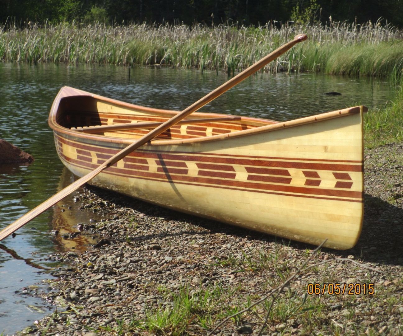

I have recently finished building a cedar strip canoe, and had barrels full of thin, small pieces of cedar and ash left over. The pieces of wood were so small and thin I had been burning them in our patio fire pit just to keep them from taking up space in the garbage. I thought .....how cool would it be to make my own paddle from the scraps left over from the canoe?! Very cool, and surprisingly easy. Here I will show you how I made the blank, or the basic shape of the paddle, that can be finished off in many ways.

The first paddle in these pictures is the one you watched me make. The feather paddle is my second. After using the first paddle a few times, I decided I wanted the shaft about 2" shorter and blade shorter and wider. I used the same technics gluing up the blade for the feather, but had a lot more, smaller pieces to glue up. The next one, with the wood burning on it, is made similarly, its a double bladed kayak paddle. The shaft is a old stairway hand rail, and blades are a kitchen drawer I disassembled, 9 ply maple plywood, very dense and hard. I did not use fiberglass on the kayak paddle, its used and abused the most of my 3 paddles and is holding up great...Let your imagination run wild making your paddle and have fun with it.
The canoe was also a project using up materials I had on hand, the entire canoe I spent about $60 on wood! A link for that build is here..
