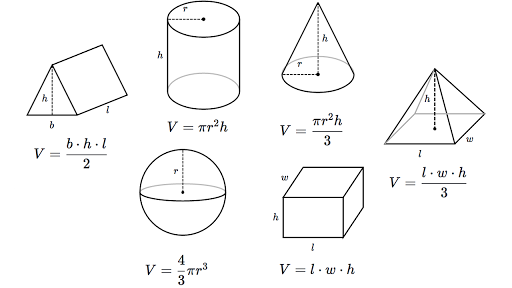

If you need to find the volume of mold you must pour into your box, then I recommend either pouring water into the mold box (this method is great because it also makes sure that your box won't leak) or using geometry formulas and converting to ounces. I have included a picture of basic volume formulas from Khan Academy.
I recommend pouring at least half an inch of mold above your object so that the mold stays secure and durable.
