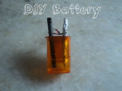

Step 2: Making Cathode
Most of the dry cells they consist of a Carbon Rod (what we need) surrounded by moist electrolyte paste.
Cathode (Positive ): Carbon
Use the pliers to take out carbon rod from the cell.Once its off, you will see the top of the carbon rod, slowly pull until the carbon rod is out.
Step 3: Making Anode

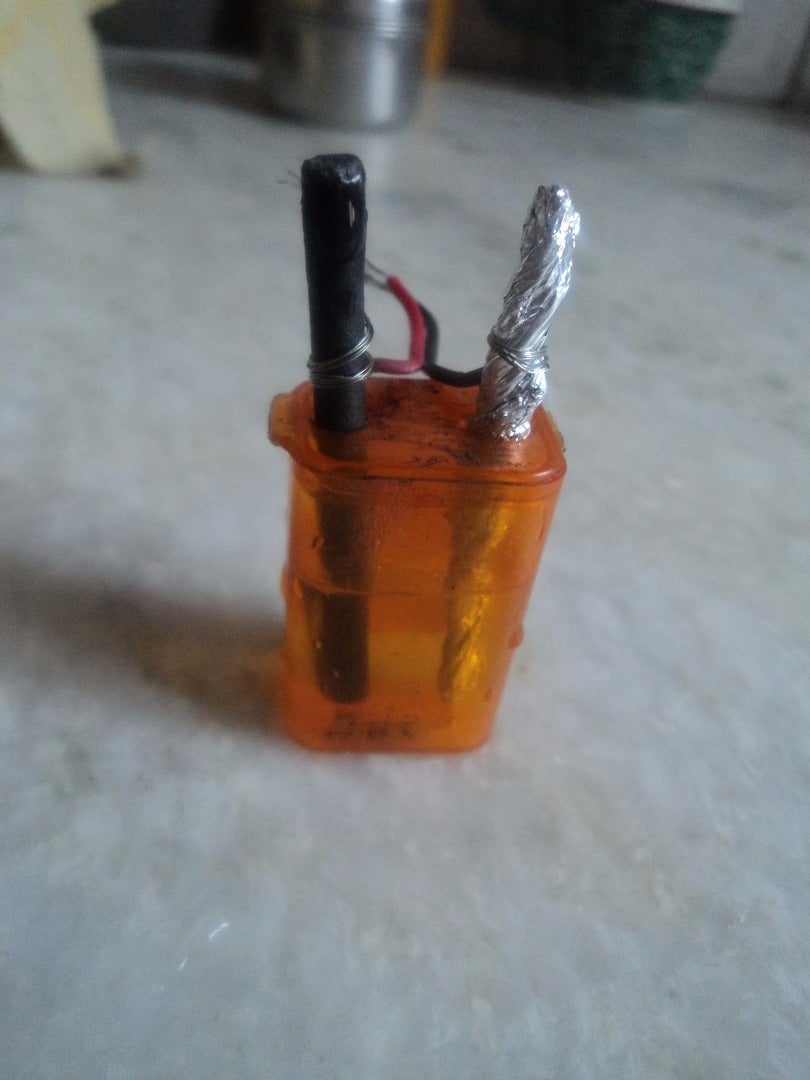

To make anode we need aluminium foil to be folded into same size as carbon rod.Fold it Hot dog style and then roll it up so its around the same size and length as the carbon rod.In many other projects zinc anode had been used but aluminium foil also works instead of zinc strip.
Step 4: Inserting Electrodes
Drill a whole the size of the carbon rod so it fits snug. Place the carbon rod into one of the hole leaving about 1/2 an ince sticking out from the top
Now do the same for the foil strip
Step 5: Connecting Wires
The carbon rod is now +
The foil is now -
just take two wires and connect them to the two electrodes . Use glue to make it water proof .
Step 6: Making Electrolyte
Fill the tiny container with a salt water mixture and place the lid back onto the container. You are now done.Mix it fully to make a solution . If desired make it saturated.
Step 7: Done!
The current is not too much strong but can be generated more if many batteries like this are joined in series.Just think of the limitless possibilities you can create with your own batteries. Not only do they work, they also reuse old dead batteries, preventing the creation of electronic waste.
