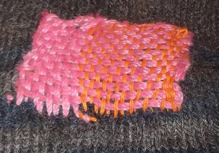

How they perform
These looms do make quite a fine guage darn comparable with a thick silk stocking.
They arent as perfect as the oldy worldy 'speed weeve' looms but being able to make them yourself means you can customise the width or guage.
Mine both look really crude but they work really well.

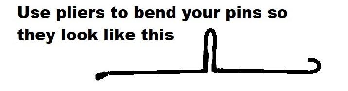

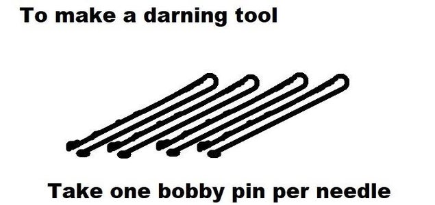

Step 1: First the Hook or Needle Part
You need to have metal hooks or Needles to hook your thread around to make the darn .
I first tried Copper wire from some old spare Power Cable . The thick kind you use for installing ovens or adding new power sockets is ideal as the wire is really stiff.
On my larger loom I used hair grips which I think are called Bobby Pins in the USA which are already straighter and have a useful curve midway which is just right to get the loop shape. They also are a little bit flat so help with lifting the second thread when pushing left and right on the loops.
You need to have the business end of your hooks curved so a thread can be held in place and I found pointed pliers were good for wrapping the copper wire end into a hook shape.
There needs to be a loop about 3cm or so away from the hook for the manouevering part.
On the bobby pins, the half way point already has a loop so it is easy to hold them in pliers and bend the legs up at 90 degrees

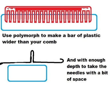

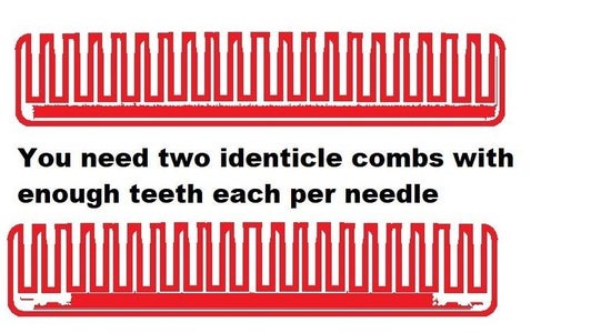

Step 2: The Track for the Loops and Base
You need some sort of grid to allow your hooks to swivel but not flap from side to side.
First I tried plastic canvas which you can bend up and gives conveniently space holes but the holes were too far apart for my attempt to make a finer guage.
So I looked for combs.
For the finer guage small loom I found an old thinning comb (the kind that holds a razor blade for hair cutting) which had teeth small enough to allow the copper wire to slot in and swivel but not slew sideways. There are usually two sides to these little combs so I was able to use one bit for each side of the track.
You could most likely use a fine toothed hair comb just as well but I didnt have one to hand at the time.
For the wider loom with the bobby pin hooks,I found a standard wide toothed comb was perfect.
You may need two the same to get enough teeth if you are using a comb with both kinds of teeth.
You only need enough length to hold your desired amount of hooks plus about 1cm each end.
Cut the comb a bit long just till you have tested the fit.
Try the hooks for size with one comb above the loops and the other below so the loops are in the track between them..
Make your base piece from Meltable plastic as this is easy to embed the combs in.
It needs to be longer than your cut off comb, About half as wide as the hooks are long and deep enough to take the teeth of the combs minus the little gap for the bobby pins /wire to be able to swivel.
You can make one of polystyrene foam packing first to test for size as the combs will just press right in easily.

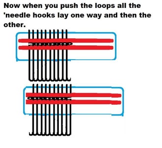

Step 4: Test It
You should be able to push the loops and they all should fall to one side like dominoes, then push the loop back and they should all go the other way.
When they are uppermost, the hooks should also be uppermost.
If you find the loops try to catch each other , thread a bit of stiff wire through all of them and bend up the two ends. This will act as a sort of inner track and stop them catching and it also means they wont fall completely flat and become unreponsive.
Its all a bit trial and error at this point and you might find you need to add a bit more melty plastic for end stops .
It all depends on your design.
Once its sorted you can see the reason for the loops.
When right , the left most threads of your darning thread will be more obvious and when left, the right most are more prominent.
For me the bobby pins did work slightly better as they are a flat wire not so rounded but both kinds of hooks worked to some extent.
If your pins are very close, it helps to waggle the straight bits above the comb tracks to help you see one from another.

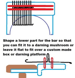

Step 5: Last Step Adding a Way to Fit the Darning Surface
On my first loom , I made legs to fit around my darning mushrooms.
One of my mushrooms is just a flat disc with a gap for elastic so looks like a cookie.
The other looks like a wooden mushroom.
This is why meltable plastic was chosen.
You can take your mushroom and holding the loom to it, position your hooks over the top part so they rest on it.
Then take a bit of the melted stuff and add it to each side so they come behind the top and sides of the mushroom.
It doesnt need to be a tight fit, its just to allow you to be able to position the loom .
When its cold and hard, put it back and see how you can hold it to the mushroom with elastic.
You might need to melt a track in the plastic of the loom to take some or add a sticking out bit.
It really is very dependant on your choice of 'mushroom'
Remember you can use anything as a mushroom , it needs to be hardish and small enough to fit into or behind the material being darned.
On my second loom, I made it Flat where it fits a mushroom and instead of a curved or round mushroom ,I can sit it on a small box or a piece of wood. So instead of adding legs , I made sort of horns at the top above the straight end of the needles so elastic will stay on.
Anyway this part of the make is entirely dependant on your needs and the meltable plastic makes it very easy to try different things till you find a working configuration.
You are aiming for being able to position your hooks above the hole, have the elastic hold the loom secure enough that you can let it go without the loom falling off and be able to add your darning threads without having to think about it all slewing around..

These looms work well .
They arent as perfect as the old world looms but they do make darning easier as you can see where you are in the darn. You can leave off darning and come back to them later without going wrong when you take it up again.
