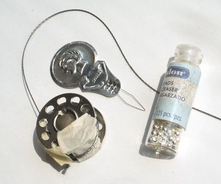

Step 4: Connect Your Board
Sew the board to your fabric, like you'd sew a button. I used a beading needle and "invisible" thread.
Solder (or sew) the lines from the board to wherever they need to go.
Finally, program your chip, and gently press it in to the chip socket.
