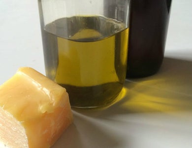

This is an extremely simple moisturizer -- you will only need oil, wax, and soy lecithin. You can also add a few drops of vitamin E and some essential oil, or use herb-infused oil.
In the version I have here I used:
  • 1/2 cup mint infused olive oil (about 100g)
  • 4 tablespoons of soy lecithin (80g)
  • 25g of beeswax (this was a chunk about 2.5x3x3.5cm)
  • I also added about 1/2 teaspoon of vitamin E (1g)
As with any moisturizer or balm, ingredients can be substituted or even omitted -- but keep the soy lecithin, which is the ingredient which makes this such a wonderful and unusual balm. Lecithin is a common ingredient in moisturizers and even chocolate, but the proportion used here is higher here than you will find in most creams.
You will need to buy the liquid soy lecithin in a bottle -- don't try to cut open the gel pills which are sometimes sold as dietary supplements. You need too much of the lecithin, and the gels are too slippery and viscous to dissect. This means that you will probably have to order it online. I've bought some for Soap Goods and from Mountain Rose Herbs, but any cosmetic supplier will carry it.
