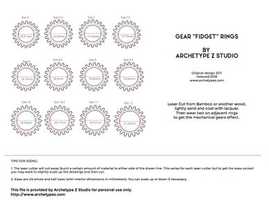

For whichever options you choose, just be sure to laser cut the sizes you need -- or cut a bunch of different sizes and see which ones fit best. I've provided a pdf here that has a template with different ring sizes and an EPS file - if you need to make any adjustments - is available on my website (scroll down to the bottom of the linked page). I have full and half sizes on the template but you should keep in mind that with laser cutting a certain amount of material will be burned away. So if you want a ring that is exactly size 7 for example, you will want to scale the drawing up slightly (or offset the inside circle a certain amount). You will also want to keep text and lines that won't be cut in different colors, layers. or line weights. This really is dependent on the laser cutter software or the service you will be using so I've just made the dimensions/text, engraved lines, and cutting lines different colors.
