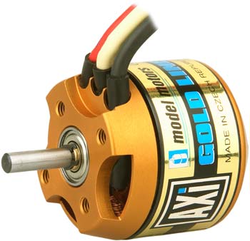

At the heart of most hub motors is a brushless DC motor. To build a hub motor right, you need to understand some basics of brushless DC motors. To understand brushless DC motors, you should understand brushed DC motors. If you've taken a controls class, chances are that you've used brushed DC motors as a "plant" to test your controls on.
I've highlighted and bolded the juicy stuff that you'll need, but for the sake of continuity it's probably good to grunge through all of it anyway.

BLDC motors lie in the Awkward Gray Zone between DC motor and AC motors. There is substantial disagreement in the EE and motor engineering community about how a machine which relies on three phase alternating current can be called a DC motor. The differentiating factor for me personally is:
In a brushless DC motor, electronic switches replace the mechanical brush-and-copper switch that route current to the correct windings at the correct time to generate a rotating magnetic field. The only duty of the electronics is to emulate the commutator as if the machine were a DC motor. No attempt is made to use AC motor control methods to compensate for the AC characteristics of the machine.
This gives me an excuse to use DC motor analysis methods to rudimentarily design BLDC motors.

� Single bearing systems represent the vast majority of your average R/C outrunners. While most of those use a live shaft, the principles are the same: the rotor is supported only on one end, and the other is open to air.
Besides exposing the internals of your motor to weather and debris, knowledge of some intermediate mechanical engineering principles is needed to correctly design a single-bearing system. I will not consider single bearing motors, because they are mechanically less durable than an equivalent sized double bearing motor.
You CAN have a single bearing motor with double frame attachment, but then it's just pointless, no?
