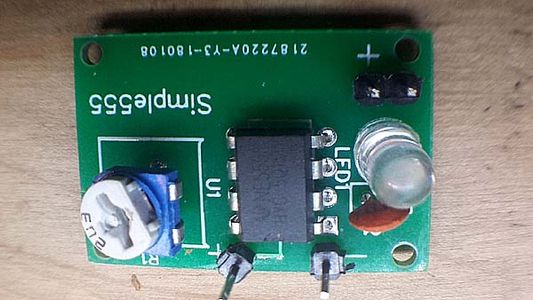

Step 12: Wait About 7 Days
In about 7 days your new PCBs will arrive!
Step 13: Solder It Up!
Solder up all of your components.
Step 14: Test It Out
Test out your design. You just made your own circuit on a PCB!
