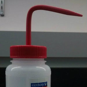

Here is a whole list of ingredients and equipment used:
Equipment:
-For safety, always wear safety glasses and nitrile gloves
1. Oven with ventilation
2. Air tight box with an air pump that can pull a vacuum
3. Balance for weighing things
4. Large glass slab
5. Glass slides (75 mm X 50 mm X 1 mm)
6. Silicon rubber sheets (3 mm, 1/32 in, and 1/32 in with adhesive backing)
7. Plastic pipettes
8. Disposable stirring sticks
9. Delicate paper wipes
10. Squirt bottle
11. Metal Ruler
12. Razor blade
13. Disposable cups
14. Oven gloves
15. Heat gun
16. Double sided foam tape (2 in wide)
17. Microfiber cloth (something that doesn't scratch the PDMS)
Chemicals:

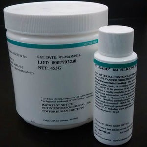

1. Acetone (put into squirt bottle, used for cleaning)
2. Glass primer (we use Wacker Primer G 790)
3. PDMS mix (we use Sylgard 184)

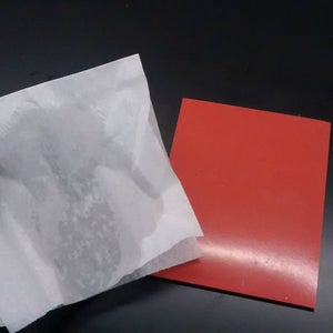

Step 2: Take Out the Old Window
While the window might be done for, the tray is most likely still fine. To remove the window, a heat gun was used to heat the bottom side of the window until it is almost unbearable to touch. Then, the window is slowly pushed out using gradual force.
The resin tray still had some sticky residue from the tape, it was cleaned with a razor blade, and paper wipes with a little acetone. Be careful, as the acetone can actually start to dissolve the tray. However, if applied only on the lip where the window is attached, it roughens the surface, and prepares it for adhesives later.

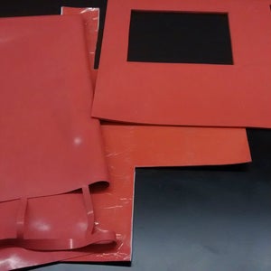

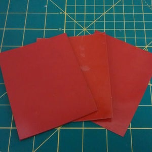

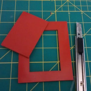

Step 3: Cut Out Your Silicone Sheets
The glass slides are the right size to fit correctly in the resin tray. Using it as a guide, a rectangle is cut out that is larger than the glass slide, leaving a generous border on all sides with all three kinds of silicone sheets. All three types of silicone sheet are cut into roughly the same size.

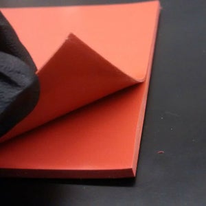

Step 4: Stick the 3 Mm Silicone Sheet to the Adhesive 1/32 in Silicone
The surfaces of the silicone sheets were cleaned with acetone and paper wipes until there are no dust or debris on the surface.
Then, the backing for the 1/32 in silicone sheet that has the adhesive is peeled off, and stuck together with the 3 mm sheet. Most of the trapped bubbles were pressed out.This new piece will be referred to as the thick silicone sheet
The thick silicone sheet gave the right total thickness to make the PDMS that is about 3 mm thick in the end.
The 1/32 in sheet without adhesive is saved for the next step.

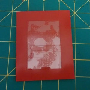

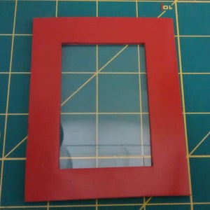

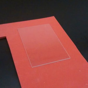

Step 5: Cut Out the Mold
The glass slide is positioned in the middle of the thick silicone sheet, and using the edges of the glass as a guide, a hole is cut in the silicone sheet that is the same size as the glass slide.
This step needs to be fairly precise. After the hole is cut, the glass slide should snugly fit into the hole.

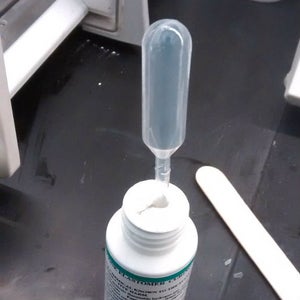

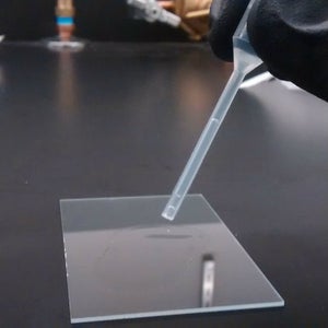

Glass slide:
The glass slide is treated with the primer. 2-3 drops of the primer were dropped on one side of the glass slide, and spread thinly using the paper wipe. It was air dried for at least 1 hour. Don't wait too long before using the primed glass, as the primer's effect could lessen.
Note: Keep track of which side the primer is applied on, because after it dries, it can be hard to see. Both sides of the glass can be primed so there's no confusion, but the primer on one side needs to be rubbed off later, which is a bit tedious.

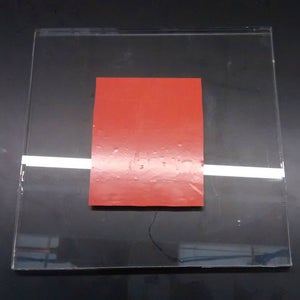

Step 7: Assemble the Mold
The 1/32 in silicone sheet is put onto the glass slab. The glass slab helps stabilize the assembly, and evenly distributes the heat.
The silicone rubber, if clean, should lightly stick to the glass by itself. Again, trapped bubbles were pressed out.
Then, the thick silicone sheet is put on top. It stuck to the first silicone sheet.
Lastly, the glass slide is inserted, primed side up, into the hole in the thick silicone sheet, making sure it goes all the way to the bottom. It was visually obvious when the glass touched the bottom.

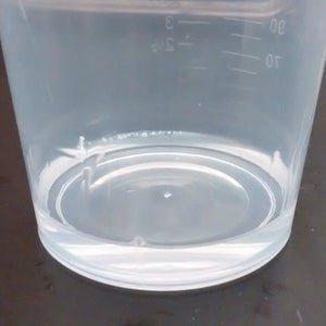

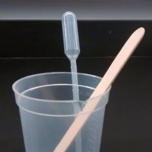

Step 8: Mix the PDMS
The two parts of PDMS is added in a disposable cup. For Sylgard 184, it is a 10:1 mixture. About 15 g of PDMS was weighed out, which was just a little more than necessary for one window.
The two parts were thoroughly mixed with the stirring stick. This introduced a lot of bubbles, which is unwanted. To get rid of it, the mixture is put into the vacuum, and stayed inside for about 30 minutes. This helped the bubbles rise to the surface, and pop. Not all of the bubbles were gone, but it didn't matter, because it was vacuumed again in the next step.

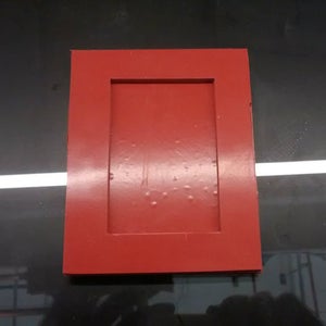

Step 9: Prepare for Curing
The mixed PDMS was poured into the mold, making sure that all of the corners are filled. PDMS was poured till it goes to the top of the mold. It was found that it is better to overfill than underfill, because with surface tension, an underfilled PDMS window has slightly higher edges than the middle, which can lead to jamming.
After pouring, the whole assembly was put into the vacuum, and vacuumed for another 30 minutes or so. After a long time, certain tenacious bubbles still won't pop. However, when the vacuum was released a lot of the bubbles popped, and the rest were popped or picked out by the razor blade.
All of the visible bubbles need to be gone, because bubbles left in the resin will expand in the oven and make a big hole in the PDMS.
Step 10: Cure Your PDMS
The whole assembly is put into the oven at 150 degrees Celsius for 30 minutes (this is for Sylgard) to cure the PDMS.
It is advisable to make sure the oven is a level surface, because it will ensure that the window has a consistent thickness.

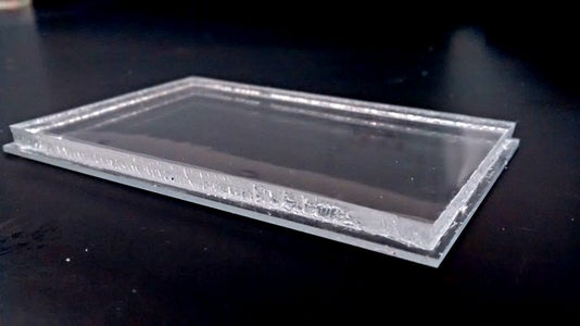

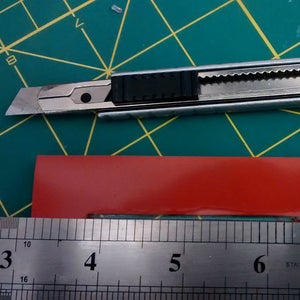

Step 11: Cut Out the Window
The assembly was taken out of the oven with oven gloves(careful, it's hot!), and left to cool off. The silicone sheets were peeled off of the glass slab. It came off fairly easily when Rain-X was used.

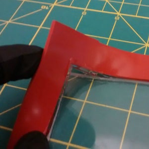

The 1/32 in silicone sheet was peeled off. This leaves the window surrounded by the thick silicone.
Using the ruler as a guide, it was positioned a few millimeters in from the PDMS - silicone interface, and using a single, steady stroke, the entire length of the PDMS was cut on all four sides. Cutting a few millimeters in is helpful because it is easier to extract the window, and it has a smaller chance of cutting up the silicone mold, so it can be reused.
Pressing down on each of the four corners, the window is carefully extracted from the silicone. The corners were pressed because they tend to be the points where the PDMS starts to peel off of the glass.
The window is now complete.
