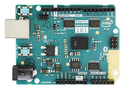

2.1 - Arduino 101.
The reason why we're using arduino Board is quite important. This new board includes the accelerometer and the bluetooth inside. In addition to that, It's cheaper than buying an Arduino UNO and the two components mentioned above separately. Let's not forget that Arduino 101 is going to be the brain of the drone.
2.2 - The Accelerometer.
As mentioned before, if you buy Arduino 101 you'll have the accelerometer inside. Let me remind you that the accelerometer is the one that calibrate and stabilize our drone to avoid possible accidents.
2.3 - The Bluetooth.
As the accelerometer, it's include into the Arduino 101 Board. The Bluetooth will allow us to communicate the Arduino with the Mobile App.

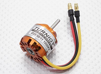

2.4 - The Motors.
We are going to buil a quadcopter so we need 4 motors. As we are doing our drone with a 3D printer, it'll be very light so we don't need a very powerful motors. In my case, I've chosen "Turnigy D2830-11 1000kv Brushless". It has the right potential and it's not expensive at all.

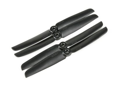

2.7 - The Propellers.
The propellers are coupled to the motors so, as they spin, the drone will ascends. Let me remind you that the size of it has to be proportional to the size of the drone.

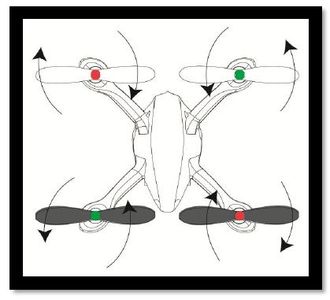

First, locate Arduino board into the central part. Then, set the four motors into the circular parts of the legs. Once we have this, we're going to link the motors with the Arduino Board by using the ESC's. Finally, we are going to connect the battery.
We're going to connect each motor cable with the ESC cables. Two motors are going to be connected with the same colors, and the others to are going to be connected in the reverse way (As you can see in the photo).
