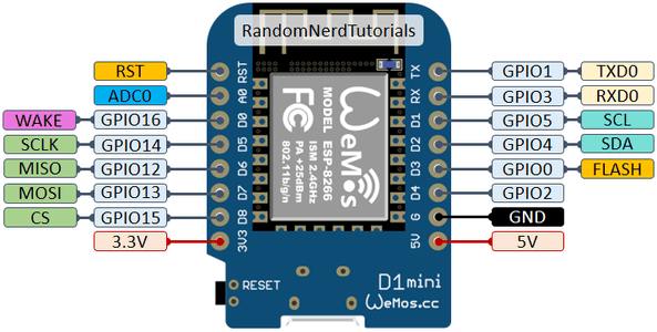

A word of caution though. The pins cannot be interchanged and has to be used as it is. The Pins used with Wemos are D6, D7 and D8. They translate to GPIO numbers 12, 13 and 15. Please refer to the pin map attached.

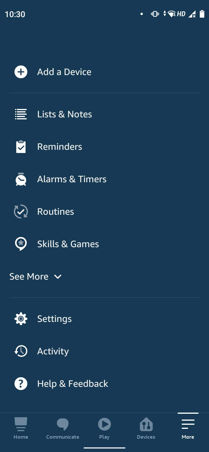

1. Open the Amazon Alexa app and tap on the More tab.
2. Under More tab, tap on Skills and Games.

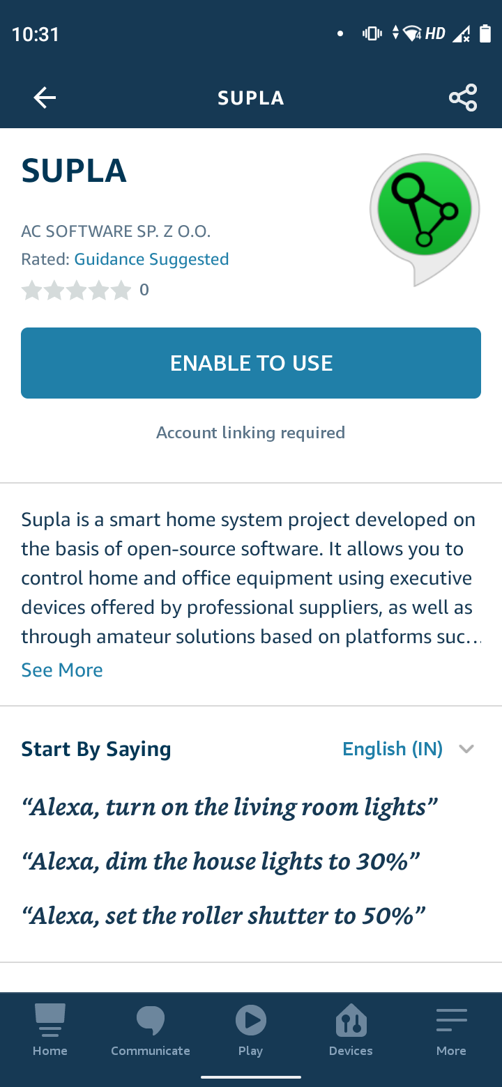

3. tap on the search icon and look for Supla Skill.
4. Tap on Supla Skill and Enable it.
5. You will be prompted for SUPLA credentials and upon providing them, SUPLA will get linked to the Amazon Alexa Voice service.
6. Choose the discover devices option. At the end of the discovery, the SUPLA devices should get listed in the Amazon Alexa devices option.
