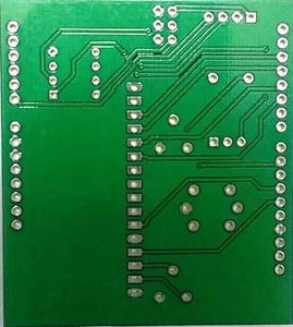

Step 4: Prototype PCB:

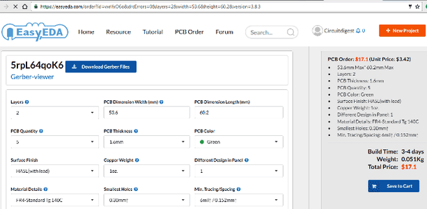

Once you're happy with the design, you can click the icon of Fabrication output, which will take you on the PCB order page. Here you can view your PCB in Gerber Viewer or download Gerber files of your PCB and send them to any manufacturer, it’s also a lot easier (and cheaper) to order it directly in EasyEDA.
The cheapest option is for 10pcs of 50mmx50mm boards, which comes to 9.8USD. 10pcs of 100mmx100mm boards is 17.6USD. For larger boards, 5pcs is cheaper than 10pcs.
Step 5: Got the PCBs:
affordable and HQ-PCB
I ordered 5 2-Layer PCBs. The whole process from order submission to receipt of the product took about 2 weeks.
Short and sweet: short delivery time, cheap, high quality
There are pictures of the PCB for Smoke Detector Arduino Shield.

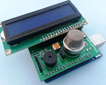

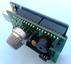

Step 6: Mounting And soldering
After getting the PCBs, we have mounted and soldered all the required components and burg strips over the PCB, you can have a final look here.
Now we just need to place this Smoke Detector Shield over the Arduino. Align the Pins of this Shield with the Arduino and firmly press it over the Arduino. Now just upload the code to the Arduino and power on circuit and you are done! Your Smoke Detector is ready to test. Check the Video below for demonstration.
