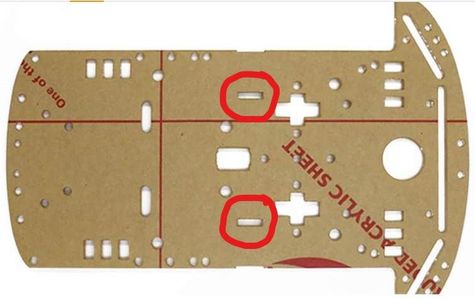

  • Motor Mounting Brackets are used to fixed the DC motors to the frame.
  • Slide the bracket into the slot indicated in red circle in the 1st image and flip the unitto start mounting the motors.

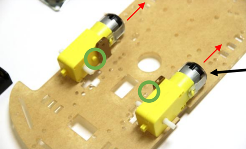

  • Ensure thedot is facing inwards when assembling the frame to the chassis.Shown with a green circle.
  • The wire leads will be facing outwards.
  • The motors will be facing the bottom. Shown with the red arrow
  • Place another Motor Bracketon the outside, the grove will allow for the bracket to slide in.
  • Using the long screw provided, slide it into the two brackets and motor.
  • To fasten the nut, gently squeeze the motor and bracket and push the unit outwards.

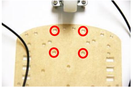

  • Using thebrass spacers and screws, mount the caster wheel on the same side as the motors. The wheel will align over the circled holes shown in the 3rd image.
If you are facing any problems, check the attached images.

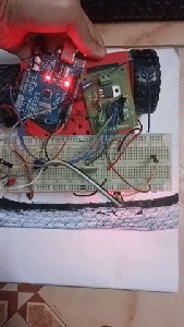

Step 4: Arduino Circuit for Each Sumobot
For the Arduino circuit of each sumobot, we will need :-
  • 1 Arduino UNO
  • Li-ion batteries ( 3pcs where each piece is 3.7V)
  • 1 Motor driver module
  • 1 piezo buzzer
  • 1 red LED
  • 1 NPN transistor
  • a 220 OHM resistor
  • a 1K OHM resistor
  • 1 HC-05 Bluetooth module
  • 1 IR sensor
Connections :- ( If you face any problems, look up the attached image for clearing your confusion.)
  1. HC-05 Bluetooth module to Arduino :
  • RX to Digital Pin 11
  • TX to Digital Pin 10
  • GND to breadboard - power rail.
  • VCC to breadboard + power rail.
2. IR sensor to Arduino :
  • OUT to Digital Pin 12
3. L298n motor driver module to Arduino :
  • INT 1 to Digital Pin 3
  • INT 2 to Digital Pin 4
  • INT 3 to Digital Pin 7
  • INT 4 to Digital Pin 8
  • 12V connected to POS terminal of Li-ion battery
4. L298n motor driver to motors :
  • POS terminal of left motor to OUT 1
  • NEG terminal of left motor to OUT 2
  • NEG terminal of right motor to OUT 3
  • POS terminal of right motor to OUT 4
5. Red LED to Arduino :
  • Vin of LED to Digital Pin 9.
  • GND of LED is connected to breadboard - power rail using 220 OHM resistor.
6. Buzzer to Arduino :
  • Vin of buzzer to breadboard + power rail.
  • GND of buzzer to collector pin of transistor.
  • Base of transistor is connected to Digital Pin 2 using a 1K OHM resistor.
  • Emitter of transistor to breadboard - power rail.
7. Other connections :
  • Arduino Vin is connected to 5V supply of L298n driver.
  • Arduino +5V OUT to breadboard + power rail.
  • Arduino GND to breadboard - power rail.
  • GND of Li-ion battery to breadboard - power rail.
NOTE : The IR sensor should be attached to the lower side of the bot and at a distance of 2cm from the ground/battle ring.

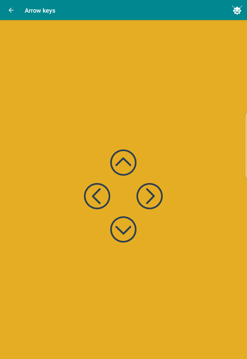

You may use the app ' Arduino Bluetooth control ' for connecting the smartphone to the sumobot.
After opening the app, pair your smartphone to the device named ' HC-O5 '.
There are several options using which you can control the bot like : arrow keys or keypad etc..
I suggest that you should use the arrow keys as they might work better. However, it's your choice how you wish to control the bot.
You can change the button's sensitivity from the settings.

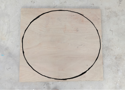

The battle ring will be very easy to make !
All you need to do is make a huge black circle which can easily accommodate the sumobots. The circle should be huge enough for the sumobots to move around.
Fear not ! The circle doesn't have to be perfect.
