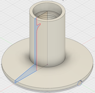

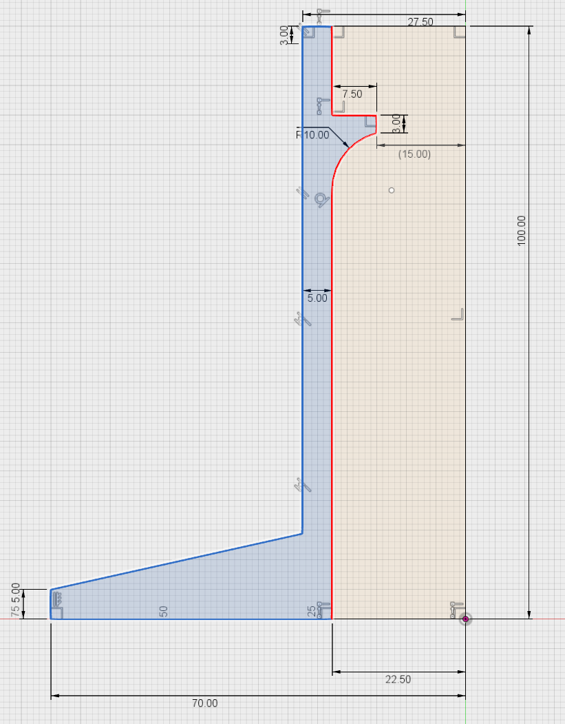

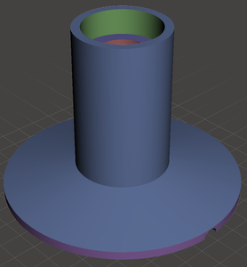

I created a simple treetrunk to fix the bulb socket in the middle of the tree.
I added a channel to the base for the cable ...
I exported this trunk as stl file, so I can import it to meshmixer ...

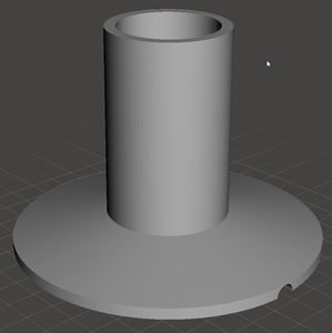

The important point is to prevent Meshmixer from changing something at the groundplate or something from the middle part, which is for the bulb socket. So i did the following:
- import trunk stl (pic 1)

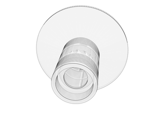

- via ( Edit --> Generate Face Groups ) I create some face groups ( pic 2 )

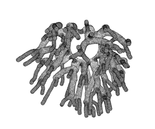

- I pressed "STRG - G" to create one new face group ( pic 3 )

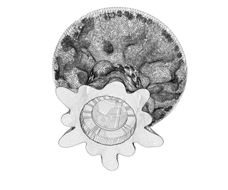

- I set some settings in sculp mode ( pic 4 )
- important is: Surface ON, Flow OFF, All Filters ON

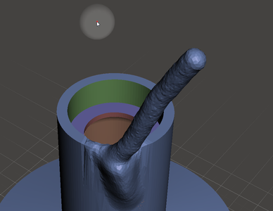

- first use a big tool size to create the big roots (pic 1) ...

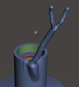

- then decrease the tool size to create the smaller one (pic 2) ...

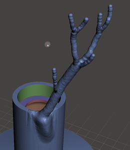

- to create the tree top I changed the sculping settings to Volume ON & Flow On ( pic 1 )
- start with a big tool for the big limb ( pic 2 )
- then decrease the tool size for the smaller one ... ( pic 3 & 4 )

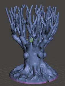

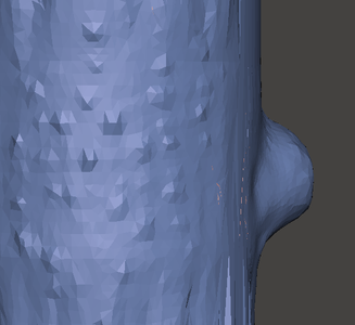

- I added a few knags ( pic 1 )
- and bark to my tree ( pic 2 )
