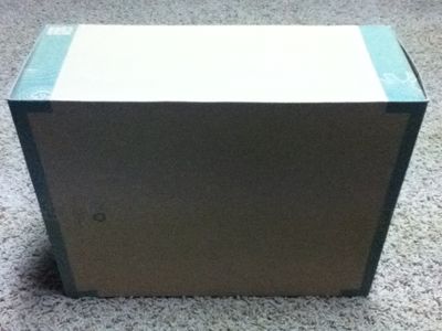

Step 7: Put the Paper on the Box
Now take the other box and use your glue stick to hook the paper to the bottom of the box (on the outside of the box).
Step 8: Hook the Boxes Together
Now take the box with the paper and take the top (where you put the lid on) of it and glue it to the top of the other box.  (Gluing top edges together.)
