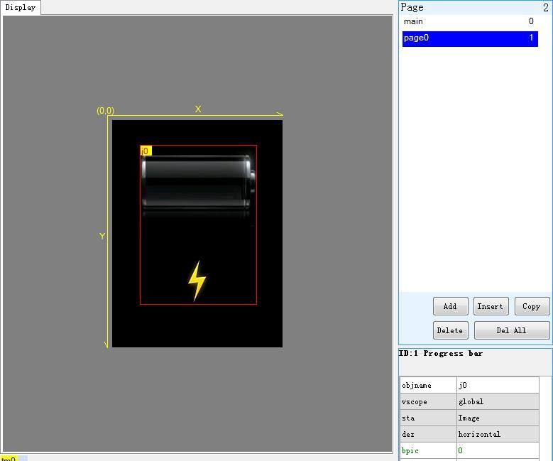

Step 6: Upload Firmware to Nextion Display
Open nextion_code/weather.HMI by Nextion Editor, then upload the firmware to Nextion display
