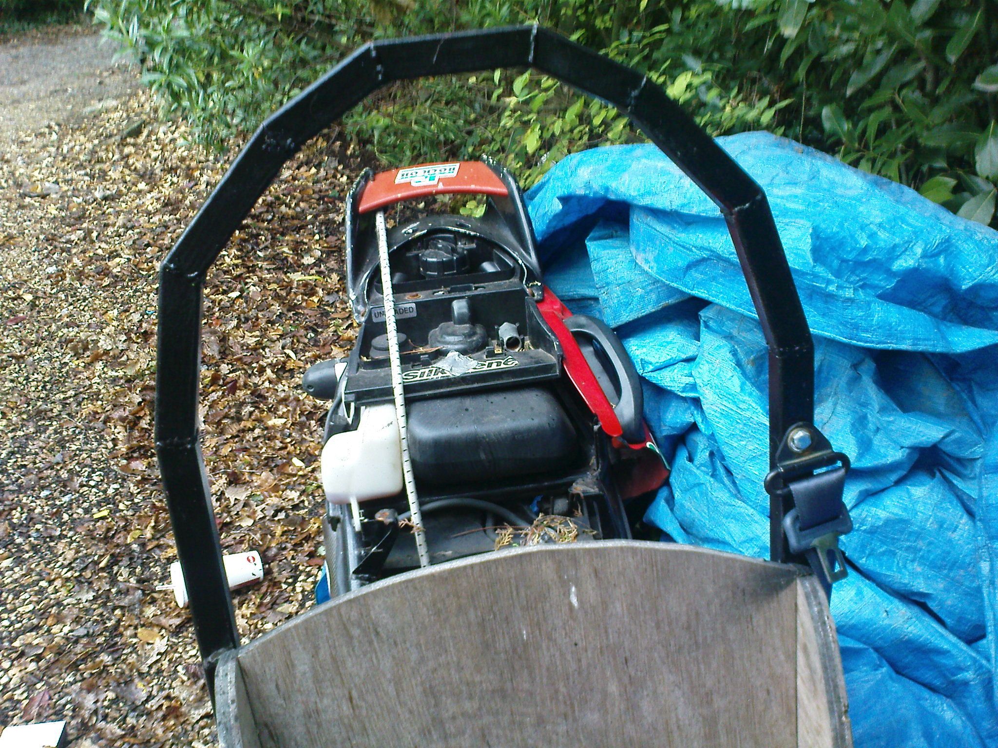

Step 4: Adding a Footrest
This step is really simple and all it consists of is a piece of plywood.
You should cut it into shape as the picture shows. I have not included any dimesons as these are specific to your mahine, so they will be obvious when you make it.
When bolting it to the chassis you should attach it to the underside of the go kart, making sure that it does not hit the wheels. Just drill four holes in the box section and four corresponding holes in the footrest.
When bolting the footrest to the box section make sure to use rather large washers to avoid the wood being crushed when the nut clamps down on it.
