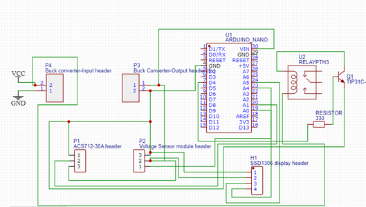

Step 1: MainBoard
This mainboard is designed solely by me. The schematic is attached, its not that difficult to make it after you understand the pins and their destinations.
The code is also attached below.
(*If you don't want to download the code, the code is in the text form at the end)

This code was a weird one. It was all a hit and trial until finally, everything worked.
Firstly, we turn on the switch, which turns on the Arduino nano. Now, the Nano checks if the voltage is correct or if the battery is low. Then, there is a 1.5 second delay, after which, the relay is turned on. This relay is the one responsible on enabling the inverter, USB port and the 12v direct terminal. If the voltage is below 11.0v, the relay will turn off and the system will shut down with a message of "Low battery" on the screen. The system will only turn on if the voltage is above 11.2v. If we try to draw more than 12A (12A because the sensor we are using has errors. So, sometimes, even at 6A load, the sensor reads it as 10A and trips the output) of current, the relay will turn off and our system will shut down.
Even if our system fails to protect the battery, our BMS will, making the system very safe.
At normal operation, the display shows the battery percentage, the voltage and the current.
Also, when the battery is charging, the battery icon shows that its charging.
I have tested the circuit and it works flawlessly. Making sure the battery is not low and making sure there is no overcurrent. One small error I noticed was that the sensor reads some ghost values. But, we cannot do much about it since its a hall effect sensor. Also, on the start-up, the board detects a non existent overcurrent which takes 2.5 seconds delay before start.

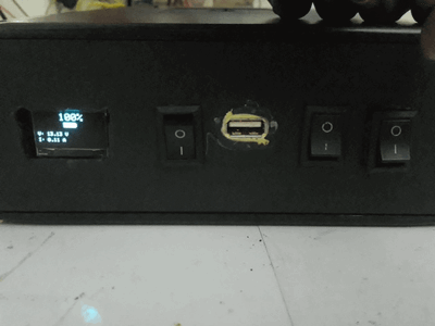

Step 7: Assembly
First, I added the switch in series to the main board so that, when the switch is turned on, the board can turn on the relay, turning on the system. Nothing special, everything as mentioned, goes into its spot. I had to make sure that neither the batteries nor their bms' terminals were exposed. I also added a 10A switch in series with the inverter and another one for the USB charger in order to save some power if we are not using both at the same time.
After that, I extended the USB ports with wires and secured the USB port, the OLED display, the switches to the front panel of the case.
I have made a 2 holes on the left side of the case for the XT60 connector. I mean, it looks weird, but trust me, some flexibility of the connector is really helpful. Especially, regarding the orientation.
I had to be careful not to connect the inverter in reverse. I then made a 4 pin jumper to connect the display and the main board. I also tried adding a powerful 15w LED light to the system, but unfortunately, the LED just didn't want to work with me, ordering it would take nearly a month (its getting too late). So, was not included in this build.
Charging the batteries was easy too, by setting my lab bench power supply to 14.4v and a constant current of 2A (0.4c in order to maximize the battery pack's life). If needed, I can fast charge it at 1c which is ~5A. And the best thing is that, charging can be done with just the 12v connector (XT60) since, it goes through the same relay, current sensor and then to the BMS. One more feature is that, when charging, the display shows that its charging to avoid confusion. The BMS would take care of balancing and preventing overcharges.
Step 8: Finishing Touches
I then installed the enclosure's screws, double checked everything, and we are done. The inverter by itself, comes with an overload protection. So, there are now three layers of protection on our build, which is really good for this low budget.
After building, this portable power station, I have tested every feature of this. Including the overcurrent protection, overvoltage protection, its mains output, its USB output, the 12V outputs, charging. The system was cool even without a fan during testing.
Surprisingly, the inverter lasted 7 hours on powering an 8W light that can light up a whole room. So, I would say, this build is a success.
The video attached below, shows the inverter powering a 20w LED lamp without any problem
