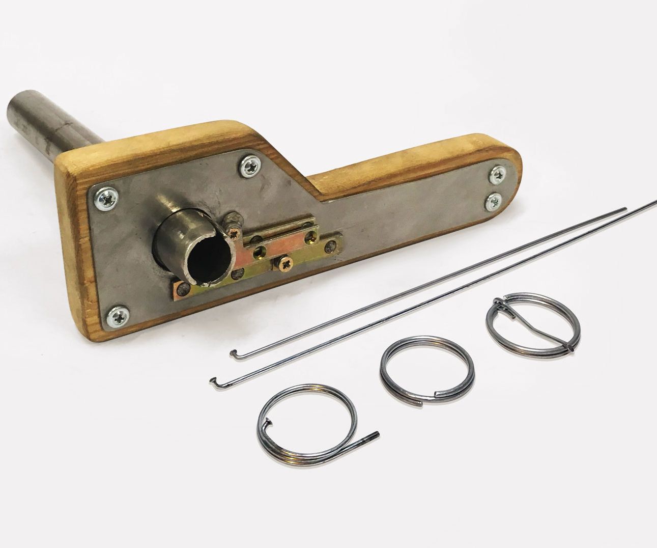

Step 6: Make the Buckle
You can either make a round buckle or a square one: in this step we provide pictures and instructions for making both shapes. Round buckles are the ones I have used in the following steps of this tutorial. The down side is that in order to make them, you also need to build a Spoke Bender. If you don't want to build this extra tool, make a square buckle instead. Here are the instructions for both of them.
Make a round buckle:
Take a new spoke and follow the video to see how to use the Spoke Bender.
- Insert the spoke's head in the slot of the seatpost and align it in the gap formed by the metal plates
- Close the spoke in, hold the seatpost with one hand and use the other to rotate the wooden piece clockwise around it
- Stop right before you've bent the entire spoke so that the metal does not spring out and gets deformed
- Cut off the straight end of the spoke with the pliers (we are using diagonal pliers here)
- Position the pliers in the opposite end by aligning it with the first cut
- Sand both ends
If the shape of the buckle is not round and tight enough, you can use pliers to twist the two ends of the spoke in the desired direction. In any case, the two ends should not overlap: keep a gap between them, as wide as the thickness of a spoke. This gap is where the buckle bar will later fit.
Extra tips:
- Thicker spokes make sturdier buckles
- Heat the pieces at 260° for 1 hour, they will be more resistant to pressure through time. You can do it at home as many ovens reach this temperature
