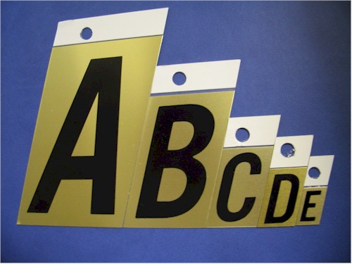

A gold number/letter sticker (one of these - go for the letter L because you get more gold space)

For the mail slot, cut out a rectangle from the metal number/letter sticker. You'll need strong scissors or tin snips for this.
If you want the dirt smudge like the door is in the series, draw on the gold rectangle with pencil and then smudge it with your thumb. Using a ruler, draw a box in the middle, where the mail will go in.
Use the gold pen to write LETTERS (good luck, it's tiny and challenging) and add the two square bits at each end of the mail slot. There's adhesive already on the back of this, so you don't even need to glue it to the door. Just peel back the clingy film.
