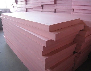

- Owens Corning pink insulating foam sheets

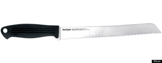

- Serrated foam cutting knife (I used my kitchen bread knife ha ha)

- Measure the back of the tank and cut a piece of thin foam that size. For larger tanks like my 120 gallon, I had to build the background in two pieces. For smaller tanks, this is not an issue.
- Dry fit the foam sheet(s) into the tank and trim where necessary.

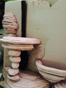

I carved my rocks as I went and kind of let the background form itself. Keep a general plan in mind but don't try to control it too much. Have fun with it!
- Using the serrated knife, start carving pieces of pink foam into shelves and rocks as desired.
- Keep in mind that the cement will fill in a lot of crevices in the foam so don't worry about perfection. The foam is merely the base.
- To create larger protrusions, stick blocks of foam together with silicone and bamboo skewers. Let the silicone cure and then carve away what you don't want.
- I looked up images of rocks (especially slate) to inspire me.
- If you like the slate look, see the above pictures to see how I carved it. You can do more rounded or blocky shapes too. Whatever you do, it'll look great once the cement is on it.
- This should go without saying, but it's really easy for the knife to slip and cut your hand so be careful! You will need all your fingers later to install the background.
- Carve your textures deeper and more drastic than you would think. The cement will fill them in a lot!

I used bamboo skewers and toothpicks to support and strengthen as I built. This will hold the pieces in place as the silicone cures. Use wire cutters to trim the skewers when necessary. I wanted to graduate my background as it went so it came out farther at the bottom and tapered at the top.
Important: I have had a few tragedies with fish getting caught in store bought aquarium decorations. I kept this in mind as I carved. You don't want to create any death traps for your fish. Avoid small sharp holes. The fish need lots of room to swim. Remember you can use the concrete to fill in any gaps you don't want.
