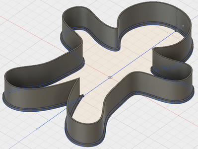

Step 7: Extrude the Sketches
- In the Create drop-down, click Extrude. Or hit E on your keyboard.
- Select the profiles you created while offsetting to 0.8 mm or -0.8 mm (the thinnest profiles).
- Enter 15 mm.
- Click OK.
- In the Sketches section of the Browser, turn the sketch back on.
- Select the profiles you created while offsetting to 1.8 mm or -1.8 mm as well as the profiles you created while offsetting to 1 mm or -1 mm (all the thicker profiles).
- Enter 1.5 mm.
- Make sure the Operation is set to Join.
- Click OK.
