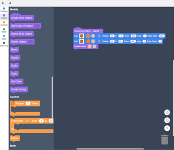

- First thing I always like to do is grab a Create New Object block from the Modify (purple) section of the left hand menu - this allows you to use the object we’ll create in other bits of code etc. but also is just a neat and tidy way of doing things!
- Next, in the Shapes section (blue), click and drag a cylinder until it’s just touching the Create New Object Block - when you let go there should be a little popping noise and it should attach itself to the previous block.
- To change the size of this block and to make it a smooth circle, click the arrow on the right of the block then we’ll set the radius to 20mm, the height to 3.5mm and the sides to 360 - to round the edges, we’ll set edge to 1 and edge steps again to 360.
- Next, we’ll add another cylinder below that one but this one we’ll make into a hole by clicking the grey button on the block.
- This will be used to cut out the centre of our first cylinder, so it needs to be smaller in width but at least as tall as it - I’ve set radius to 16 and height to 20. I left edge as 0 as we don’t want this edge to be rounded.
- Now, let’s group those two shapes using the Create Group block form the Modify section (purple)
- This will cut the centre out of the original cylinder leaving a ring shape
If you ever want to check and see what your current code is producing, just click the play button in the top right - at this point your code should look like the first pic and you should find it looks something like the first gif above when you click play!

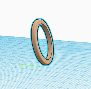

Before we move on to the next step, we're going to position our ring shape!
- Using a Rotate block from the Modify section (purple), set it to rotate around the X axis by 75 degrees - you can leave the pivot box blank. This stands the ring up at an angle - this will make sense when you see how the loop works in the next steps 😊
- Finally, add a Move block, again from the Modify section (purple), and set it to X:8 Y:0 Z:20 - this offsets your part from the origin point (the centre of the workplane) and raises it up above the workplane as well.
Your code should now look like the second pic and you should see something like the 2nd gif when you click play! Your final shape should match the last pic 😊

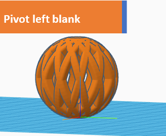

- Finally, you’ll need to change the pivot too - by default, the Rotate block will rotate the block in place which would make a spherical shape - we want more of a squished sphere shape which is why we moved our frame 8mm on the x axis earlier. We want to rotate around the origin point instead - check out the pics above to see the difference 😊
- In the empty space beside Pivot in the Rotate Around block, you’ll need another block from the Math section (green) it should say X:0 Y:0 Z:0 - just pop it straight in, those values are already what we need!

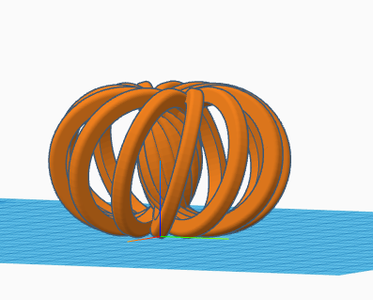

- Now, I still think this is making a shape that’s a little too round for a pumpkin so let’s use another Move block from the Modify section (purple) and set X:0 Y:2 Z:0 - this will move each copy of the frame 2mm in the y direction which should produce a slightly wider, more pumpkin-y shape!
Great! That was definitely the most complex part of the whole make so just double check your work by running your code and making sure you see something like the gif above and the end shape looks like the last pic above too! Your code should look something like the first pic!

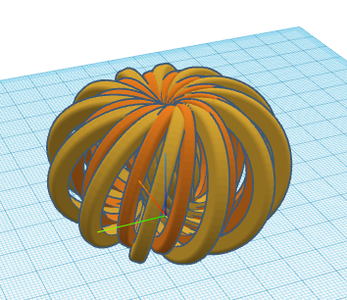

You should find that your code looks like the first pic above and that if you hit play now, you see something like the gif and are left with the shape shown in the last pic!
Perfect! You now have the Codeblocks section of this whole ible done!
Now we just need to do a tiny bit of good old fashioned Tinkercadding to give it a stalk and make it a little easier to print!

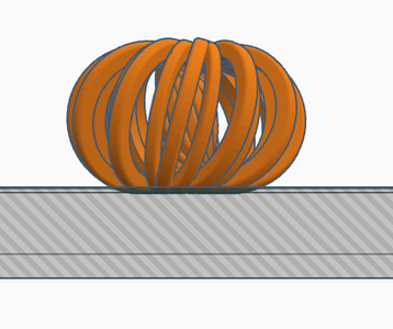

- To make this shape a little easier to print all we need to do is give it a flat base as this will help with bed adhesion.
- To do this we’ll just use a nice big box hole to cut away the bottom 1mm - you can either use a 1mm tall box hole or lower it until it's only 1mm above the workplane before grouping it with your pumpkin shape to do this.

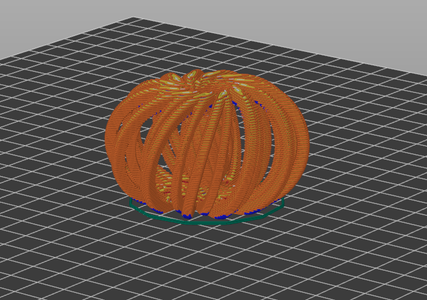

Just export your shapes (or shape if your pumpkin and stalk are all one model) by clicking the export button in the top right and selecting ‘STL’ - my stls are available free on thangs hereas well if you just want to print mine!
You can then import the stls into your slicer and slice your model ready for printing.
I’m sure you know your printer and filament better than I do so I’ll leave the slicing to you 😊
A few tips though:
- You should need no supports for this unless you scale it up hugely - I’ve actually printed this at 400% scale and, while there were a couple of slightly droopy areas, it printed well enough still!
- It will also print scaled down but remember that the smaller it is, the thinner each frame is so it’ll be less rigid and more prone to failing - I’d suggest slowing the print down and switching on z hop if you want to print it very small.
- You also shouldn’t require a raft or brim since we gave it a flat base so it should adhere to the bed just fine - if you have any issues you may need to clean and level your bed
- I found that I had quite nice results with a few filament changes throughout the print though it looks pretty neat all in orange too!

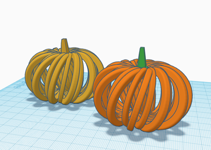

Step 9: Enjoy - and Maybe Explore Codeblocks a Little More?
Fab, you’ve made your first pumpkin - I hope you enjoyed it!
