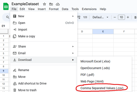

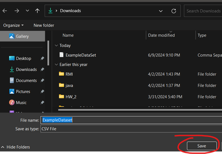

Here is the example data I will be using. Make sure that the data is as pushed up and to the left as possible or else R might not recognize the column and row names. Name your columns well as they will label your graph automatically.
Once you have the data download it as a .csv(comma separated values) file.
Feel free to use my example dataset.
