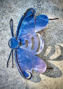

I found this metal bee shape on a rusty garden stake thing and cut it off, then drilled two holes in the top of the wood box to slide it into.

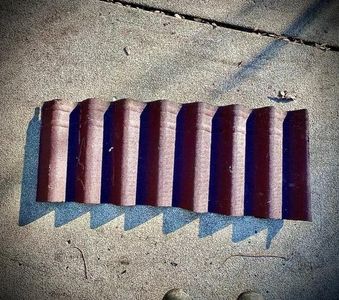

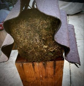

I used a scrap of corrugated waterproof roofing left over from another project and screwed it into the triangular frame. The roof should stick out a few inches over the front of the bee hotel. I also stuffed an old squished topiary moss ball into the back to provide additional options for nesting.

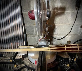

Now comes the fun part – adding the places to nest. I cut lengths of bamboo from some old yard torches and garden stakes for thinner ones. I also drilled holes in some chunks of wood, including a big children's block and used some wooden yarn spindles stuck into another old box and added some rolled up fiber from a microgreens growing mat. And a couple of bricks ( 2 deep). You can use anything here, it just needs to be holes(tubes) that are as deep as the frame.

I added a little gold spray paint to the bee on top to give it some color and sanded down a bit with sandpaper to give it an aged appearance.

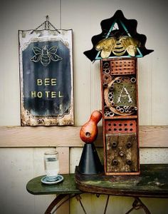

Step 7: Optional: Add Signage and Hotel Amenities
I don't know if bees can read, but who knows, they're pretty smart. But I like signage, so repurposed a corrugated metal sign I found at the dump. I painted over the dumb phrase on it with matte black spray paint then used an oil paint marker for the words. To make my hotel more attractive ( and get a leg up on the neighborhood competition ) I also added a Bird Executive Suite Annex with a gourd nest and a Fly-up Pool Bar.
