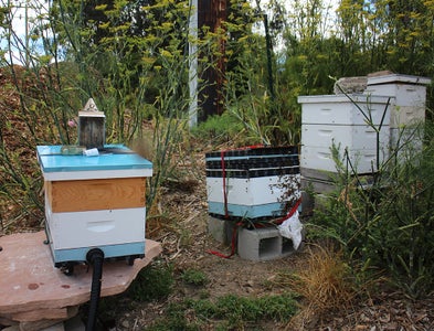

As a beekeeper, I am occasionally hired to extract hives from places where they aren't wanted. The goal is to get as many bees out of the walls without causing great harm to myself, passersby, or the bees so that I can then relocate the bees and their comb to a Langstroth hive box where they can be managed for better health and honey production.
This next set of Instructions will follow me as I go through the steps of designing and building a Bee Vacuum that Really Sucks (in a good way).

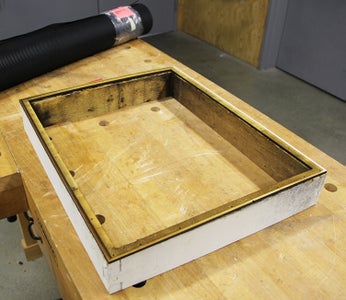

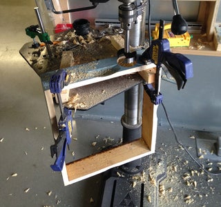

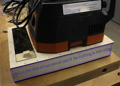

First, use a table saw to cut your empty medium super to make the top and bottom of your bee vac. Measure the hose connector and the tallest internal part on the shop vac to determine the depths of these two pieces. Make sure to cut the super so that the joints are cleanly divided between boxes, and be careful to note where any nails or other fasteners can be found, since hitting those it bad news for you and the table saw.
Note: In the photos I have different colors for these two pieces, but that's only because I cut down two different mediums to make two complete sets of parts. I had a friend who runs a cabinet shop do this for me with all my deep supers a long time ago when I switched from deep boxes to mediums to save my back from the heavy lifting. I traded him the work for a big jar of fresh honey.

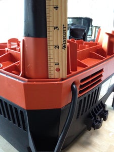

Step 3: Modify the Shop Vac
Next let's get the shop vac to sit on top of a hive with no gaps for maximum suckage.
The Fein is a beautifully engineered tool. I chose it because it has low dB level of 66. This model lacks the hepa filter, all accessories except the hose, and has a small 'bucket' where sucked up debris and solids are housed, all of which are not needed on a bee vac.
Now to modify.
I first opened the vac and discarded the 'bucket', being sure to save the attachment point where the hose clicks into the bucket. Then I removed the air filter and discarded that too. Open the motor by unscrewing all the fasteners (save for later) to disconnect the water level sensors and remove the two towers where the sensors are suspended in the bucket. Then I pulled off the buckles that clamp to top motor to the bucket. I was careful to make note of what fasteners went where and not to miss any, and this made it easy to reassemble.
Step 4: No Turning Back, Fun With the Swazall

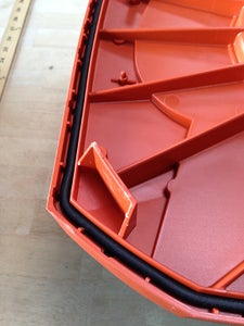

Now for the crazy part. You're going to cut off all the support material on the underside of the vac so you can get enough flat surface to make a good connection with your wooden vacuum top.
This beautiful shop vac has many support ribs that we don't need, and they will keep the 'vacuum' from happening if there are any air gaps between them and the rest of your assembly.
I measured an inch in from the edges of the vac, paying close attention to the black gasket that runs along the edge and using that as a basic guide, since this is where the seal will be made. I marked all the supports that were within that 1 inch margin from the edge.
I taped the intake for the motor to keep out any chips. Then I clamped the motor securely to my work bench using the help of my hive section and took a sawzall to it. What crazy fun that was! I'd had an illusion up to this point that I'd someday use this $300+ vac for its intended purpose, but this quashed all that for me. A swazall is a seriously destructive tool, so make sure you before you turn that thing on to use the proper safety goggles and safe workshop practices here. I made the rough cuts with the sawzall and then followed up with finer close cuts with a japanese hand saw.

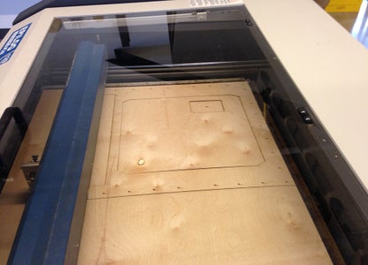

Step 5: Cheap Fun With Expensive Technology
I'm about to reveal the truth about my access to a workshop and cool tools and generous budget. I have a residency at Autodesk. It was simple to apply, and all I had to do in the interview was to prove to Vanessa and Noah that I'm good at making things, show a portfolio to back it up, and exhibit minimal social skills buffeted by extra enthusiasm. Oops, did I say that out loud? There I go again.

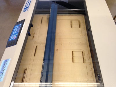

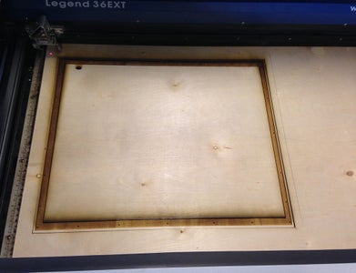

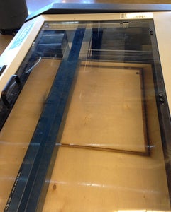

For this next step I used the super-cool, better-grab-an-ebook-on -my-iPad, boredom-inducing, stand-over-watching tool, the Epilog laser cutter.

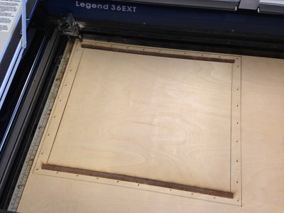

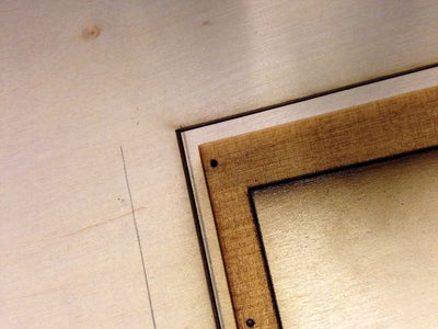

I practiced many times on the laser cutter before I was able to create a file for the top of the vac, and I recommend you do the same. Cutting paper is quicker and wastes less, and running the programs with the laser off will show you how long it takes and where the paths run before you commit to ruining your plywood.
What I cut was a 1/2" plywood plate where the vac sits on top. I measured in from the edge of the vac to make an opening in the top where the vac sits. I added cool features to the plate such as a Plexiglas window so I could see into the vac. It needs a baffle to adjust the suck power so it grabs the bees without pulverizing them. I used Illustrator to make the files, and they act kinda like print files. If you're using a fein vac then you can just use my PDF files I've linked on this page.
Note: If you use my files then be sure to repeat the raster etch on the plywood several times to make your grooves deep enough to make the baffle slider work. The files are near perfect in execution, but run a sample with paper first just be sure of your machine's settings.
Running the epilog is worse than watching paint dry because its noisy. You must stay witin a foot of the machine to make sure there are no fires. I highly recommend listing to the audiobook I did, China Mielville's The City & the City

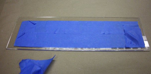

Then its time to glue the Plexiglas window into the top plate. I used blue masking tape to shield the Plexigas to keep the glue off my window. To glue in the window I used an epoxy glue of which I did not record in my notebook. But when I googled it I learned that I should have given the Plexiglas a little tooth by rouging it up with sandpaper. Next time!
The important part here is to make sure your Plexiglas fits so that you can mount this entire plate onto your box later, so make sure its oriented so that it matches the jpg diagram I've created. Be sure not to get glue anywhere near your slider track and baffle.
Let this sit until the epoxy has set.
Step 7: Design and Cut the Screen Plate for the Top
You'll need a screen between your vacuum and the hive box so you don't suck the bees up inside the motor. While your epoxy is setting on the window you can concentrate on designing and cutting the next plate for this assembly.
I've included the PDF file here for a cheat, and since this plate will fit all 10 frame Langstroth hives, it will be useful no matter which shop vacuum you decide to use.
Of note is that if this file is cut and etched all as one, it will take FOREVER! To get around this, I recommend that when sending this file to the Epilog you first hide the raster files that are on the vertical plane opposite one another. In my file I've named these V right and V left, and you'll find them in the Raster layer of the file. Otherwise the Epilog will send the laser head so that it goes, "Zip, t r a v e l, zip, t r a v e l, zip, t r a v e l, zip. Etching one vertical section at a time will reduce the amount of travel for the laser head and thus reduce the time spent standing next to the machine by 75%.

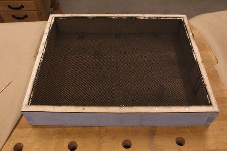

Next step is to assemble the screen plate and attach it to the box section you cut in step 2 . Once again, this is to put a screen between the bees and the vacuum motor. It's important to get a good seal between the screen plate and the screen and the box you attach them to, so I use first tacky glue then once set I go in with expanding Gorilla glue.
First use your screen plate to pilot the holes you drill in the box. Later you will use those holes to screw the assembled screen plate and screen to your box. You should be wearing your safety glasses for this.

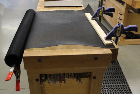

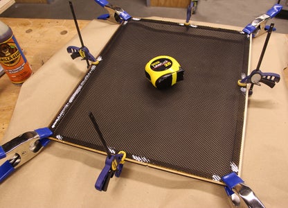

Next, cut your screen to fit the etched section on the screen plate. I did this using a cutting mat and a roller cutter, but you can use cardboard and a box cutter for this step. I've given you lots of wiggle room to glue the screen to the plate, so it should be close but don't spend too much time on this step. The expanding gorilla glue will solve all sloppiness with a thick layer of its own goo to make a good seal.
Next you will get the screen to stay in place on the screen plate with tacky glue. Its a good idea to use latex gloves for this step, and have a box of them handy so you can peel off any that have glue on them and pop on a new set.
I dab a few drops of tacky here and there and hold the screen in place with clamps until the glue is set.
Once the tacky glue holds fast you will glue the screen and plate to the box section cut in step 2 with your expanding Gorilla glue. I did this section by section, and you want to take your time with this part. The better the gluing the more airtight the seal will be between the plates, so make sure to get an even coat of gorilla glue, adding clamps to hold the screen plate to the box section as you work your way around the plate.
While still clamped, I used screws to fasten the plate to the box using the pilot holes cut by the laser cutter and the pilot holes I drilled earlier.

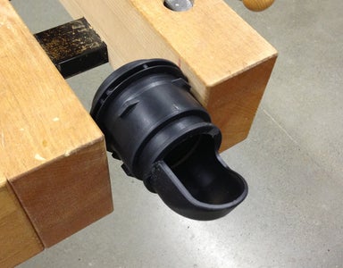

In this step you'll make another modification to the Fein vac, this time cutting the hose port where the hose clicks into the vacuum assembly. Cut away the scoop, and remove all tabs so it can slide easily into a round hole you cut in your box section from step 2. You want to make this port as low in profile as you can without destroying it, so use the Japanese hand saw and clamp that in place tight so it doesn't slip.
Then you'll make a round hole in your box section that fits this port. I used the drill press and a forstner bit that fit the port closely but not too tight that it doesn't fit the hole. My box section had a handle cutout, therefore I didn't center the hole, but this does not effect the vacuum at all whether the hose is in the center or not.
Then push the hose port into the box section and see how snuggly it fits. You want this seal to be airtight, so use the expanding gorilla glue to glue it in. For this project I did not use gorilla glue, since I want to make several vacuum assemblies. I built two at a time with the idea that I can switch out and do more than one hive in a day or back to back. You simply pull the hose and vacuum motor off the first vacuum assembly and put them on the next. I used a putty to make a seal until I can 3D cad a new hose port and print it on a 3D printer. More to come!

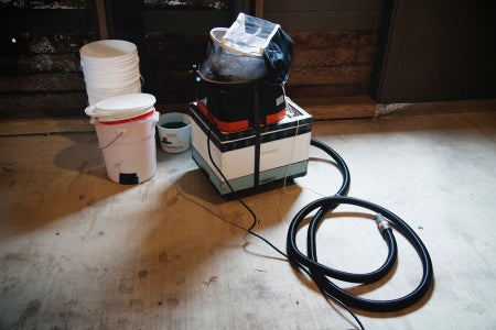

In this image I'm field testing the beast, so I have not painted it. Instead, I sealed the edges with a 10mil plastic tape. But you'll want to give everything a good coat of paint on the face and especially at the edges, since that will help seal the whole thing and make it super airtight. Maybe even do it before you put the foam seals on.
Plug in the hose, put the vac on top, and strap the whole thing down with a cinch strap. I found that while you may have the urge to loop the cinch strap through the vacuum motor, it isn't necessary, since the vacuum suction will hold that in place. An interesting feature to the Fein is that it has a flat top. I found I was using the flat Fein as a platform, like a pedestal for a table.
