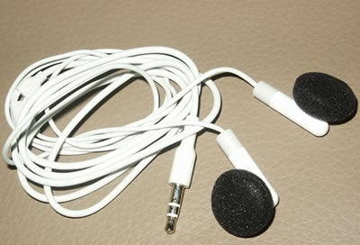

You'll need an old set of headphones (make sure the plug is in good shape first) or a 3-conductor lead with a 1/8" headphone plug at the end. Cut the headphone cable to your desired length and strip the outer sheathing, then the inner 3 wires. The colors of the inner wires should be something like, white red and black, or white red and uninsulated. To save yourself some headache in the next step, you may want to twist and tin the exposed wire.

Strip the white and red wires and twist them together tightly. By twisting these two together, we're combining the left and right audio signals into one. (As far as I know this wont cause any impedance issues, and worked for me.) The red and white twisted wire pair will be soldered to the circuit board where the speaker + was previously. The ground will be soldered to the circuit board where the ground was previously. Once your solder job is complete, place the circuit board and cable back in the housing and test it out by plugging it into any audio source. If you've paired the headset to the adapter properly and your soldering skills are good, you'll hear audio!

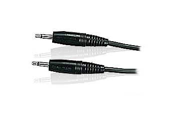

If you want to use the microphone as well, you'll need two monaural 1/8" headphone plugs and leads. (My recommendation is to buy this and cut the cable in half.) You will need to first label the ends so you know which is which when you're done. Strip the ends of both leads and twist the negative (usually black) together. Solder the twisted-together wire to where the black was previously. You may need to be clever here, the hole in the circuit board where these two wires are going is very small. On the lead labeled microphone, solder to where the white wire was previously and on the lead maked speaker, solder to where the red wire was previously.
