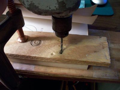

I decided to use 1/10" aluminum wire which is the same wire used to hold up chain link fence. That means I need to drill a hole slightly larger than 1/10". Since a 1/8" drill bit is .125" or .025" larger in diameter than the .1" wire diameter, I selected it.
Hole location
The closest print to the edge in my book was 1/2" (most margins are 1/2") so I didn't have to worry. I Subtracted one half of the diameter of the drill bit and marked this distance minus the diameter of the drill bit from the edge. (Center of hole is 1.5 drill bit diameters away from the print.)

Be sure to fold the covers back so you do not drill a hole in them. The closed covers are what secure the pin!
Also be sure to use a clamp and a guide hole. If you do not then the paper will ride the drill and who ever owns the book (including yourself) will have you for lunch!
