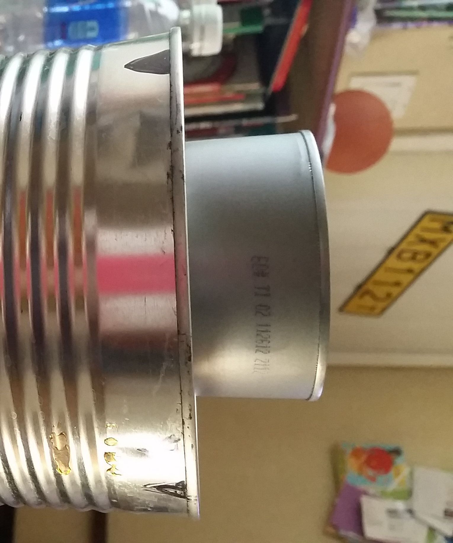

Step 8: Furnishing Your Oven
For this step you need 4 empty aluminum cans, 4 - 6" x 18" wide pieces of foil, sand or pinto beans, small grill, small aluminum cookie sheet, and two stackable pie pans. First fill the cans 1/2 - 2/3 full of pinto type beans or sand. Then tape the top of the can with a 2" piece of aluminum tape to make sure the beans and such don't fall out. Wrap the cans with foil and secure them with tape. Fold the ends over the cans and set them aside. Put the pie pans into the oven and arrange the cans in a square. Place the grill over the cans. When the coals have been heated, put them in the pie pan. Heated coals are 50 degrees each, so add as many as you need to make the correct cooking temp for whatever you happen to be making. The box oven will get hot on the bottom, so be careful if you move if directly after cooking.
