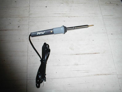

Step 1: What You Need
Tools and Parts. Here are the ones I used:
1.A regular moderately cheap soldering iron.
(not the 99 cent ones that melt in your hand though)
2.A brass rod similar in diameter to the iron's non-brass tip.
3.A rotary motor tool kit like a dremel.
4.safety glasses
5.solder
6.flux
7.Something not very important to solder the first time.

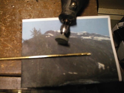

Step 3: Making the Tip the Harder Way...
Here I shined up the brass rod which was temporarily used
as part of an antenna, using steel wool. There are probably
other ways to shine it up, like buffing or using something called
"brasso". Feel free to comment on my unskilled machining "errors"
and what better ways are the best.
Then I sharpened the end of the rod, in a shape that's good for
soldering. Pointy, and kind of flat.
This is the "hard way" tip. The "easy way" tip was just cut at a
sharp diagonal leaving an elliptical facet on the soldering end.
Then I compared the size of the original tip to the rod and
cut it off there.

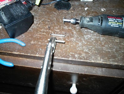

Then I "scored" and slightly tapered the cut off end of the new
brass tip I'm making and using vise-grips, cut screw-thread-like
slightly diagonal notches in a roughly spiral pattern. (In the
"easy way" I did this first and screwed it into the iron before
cutting it off.)

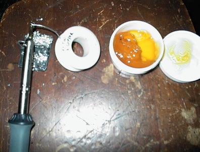

Step 4: Getting the Tip Ready to Solder
Again the easy tip was made into a screw at one end of the brass rod,
screwed into the soldering iron, and then cut off of the rest of the rod.
It was also polished shiny. (I haven't used the hard-way tip yet.)
Then I dipped the tip halfway into flux, wrapped it up in high-tin solder
(with no lead, just because it seemed like a good idea to "tin" it),
and plugged in the soldering iron with the brass tip. The solder melted
as it heated up and I added more, coating about half the brass with
the tin. Regular rosin core solder can probably also be used. This is
a totally experimental make anyway, so if it works it works.

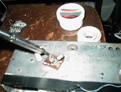

Step 5: Trying It Out - Solder a Job
I decided to use this to fix an old invention that has no
practical purpose that I made in my youth, which has
old Germanium transistors that must have shorted out.
It's a weird circuit that buzzed if you touch it.
So far, the soldering brass seems great.

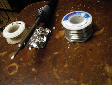

Step 6: Check the Condition of the Tip After Use
The oval tapered soldering tip surface still seems nice and flat and shiny!
I wonder how long it will last.
Remember, this is a totally unskilled experiment in soldering-tip-makeing.
Results may vary, Comments welcome! Are brass tips better or not?
