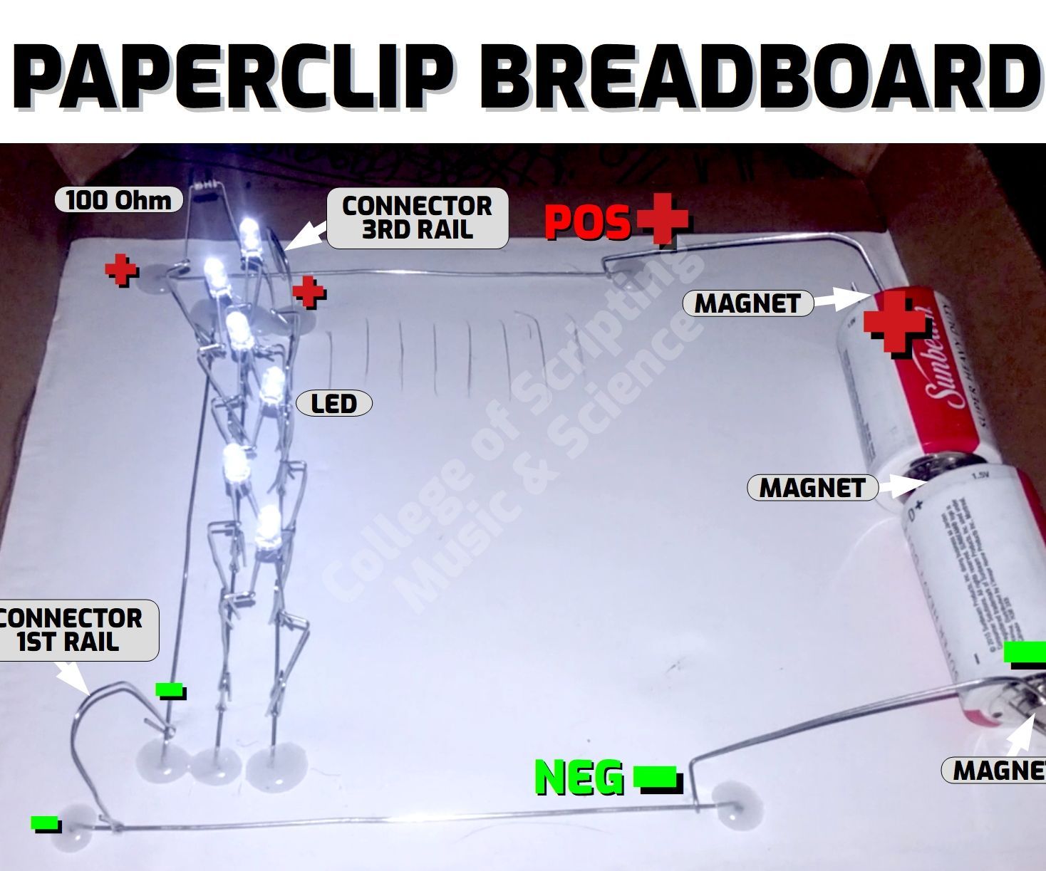

Step 3: SUMMARY: Paperclip Breadboard = Paperclip Rails + Tape + Elmer's Glue
You will be pleasantly surprised at how STRONG of a HOLD Electrical tape and Elmer's Glue can provide. You must use a good amount of Elemer's Glue over all the edges of the tape. It is a very strong bond.

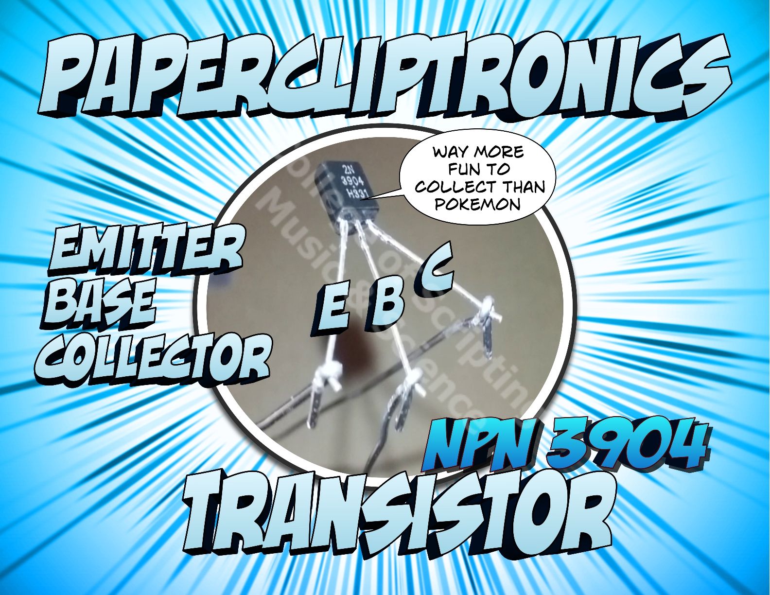

Step 6: Transistor CRIMPED With Paperclips & Bent Into Hook Shapes for Rails
We CRIMP Paperclips around each Leg of the Transistor.
We BEND the End of those Paperclips into Hook Shapes.
We CONNECT those Hook Shapes to the Paperclip Rails.
Step 7: Switch - Using Magnet (Neodymium)
We ADD a small Paperclip Rail to our Breadboard.
We PLACE our Positive Power Supply Connection onto this new small Paperclip Rail.
We POSITION a normal Paperclip under the small Paperclip Rail.
We USE a Neodymium Magnet on the Positive Rail to MAKE the Connection.
Thus, the power now goes from the small Rail to the Positive Rail at the top, from our new Switch.
NOTE: We used Electrical Tape to hold down our new small Rail. Electrical Tape is very good for temporary designs, but we can also add Elmer's Glue around the edges of the tape to make it more permanent.
