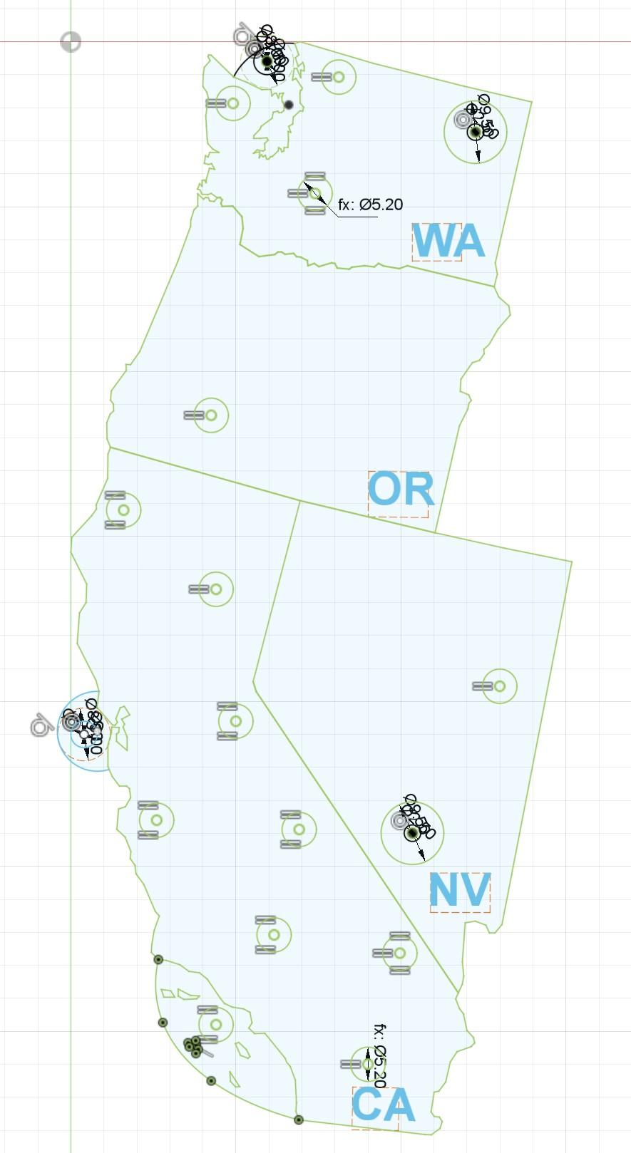

In Fusion or another CAD software, make a component for one of your sections. Make a new sketch and import your SVG. In Fusion, SVGs are not imported with the appropriate scaling. I used the measure tool to compare the height of the sketch with the height I specified in Inkscape, then found the scaling factor and put that into the import window to get the correct size. The scaling factor will be the same for all your sketches.
Next, embellish your sketch as you would like! I made these changes:
- Added each state's abbreviation to emboss into the final map - a nice touch.
- Added 5mm hole at the location of each national park, so I can insert pins later. I tried to space them farther from their actual geographical location so the pins wouldn't hit each other.
- Added 2 larger holes with 9.5mm outer and 2.5mm inner diameter. These are holes to mount with the push pins.
- Used "bridging": sketched out some of the ocean regions with curves to incorporate the islands. You can also add in some ocean to support fragile regions - I did this with the Massachusetts peninsula. I think I did this in a slightly ugly way, feel free to tune as you like.
If your sketch is not colored blue like mine, this means your regions are not enclosed. Look for where there is a gap in the outline, and connect it to close up the shape. This is necessary to extrude.
