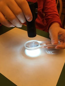

Step 1: Explore Your Lens
Have students experiment with using their lens, a sheet of paper, and an overhead light, flashlight or lamp.
Be safe: NEVER use the sun in these experiments, this can start a fire or injure your eyes. Also, do not look through the magnifier at lights -- rather shine the flashlight or lamp through the lens onto the paper or other surfaces.
A magnifying glass bends the rays of light as they pass through it, causing the light rays to converge and cross over. By experimenting with the distance between the light, lens, and the paper, you can find the distances at which you can project focused images of the light source onto the paper. (Search for camera obscura on the web for diagrams showing the path of light.)

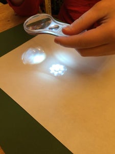

Step 2: Find a Distance
After students have had a chance to get to know their lens, have them find the distance between their lens and the paper that forms an in-focus image on the paper. It is easiest to work underneath an overhead light, but you can also set up a flashlight or lamp several feet away as a light source and work horizontally. Have students measure and record the distance between the lens and the paper when the image of the light source is in focus.
