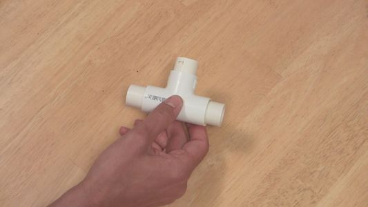

- 3 3/4" PVC tee joints
- 2 3/4" PVC elbow joints
- 3/4" PVC coupler
- 1/2" to 3/4" PVC bushing (adapter)
- 1 1/2" section of 1/2" PVC pipe

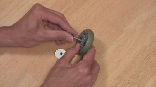

wheel assembly (x4)
- rollerblade wheel
- 2" length of 1/4" bolt
- 2 1/4" nuts
- 3/4" PVC plug
- 3/4" PVC coupler

Step 4: Build the Wheels
Step 5: Create Wheel Assemblies
Step 6: Make Main Hub
Step 7: Put It All Together
