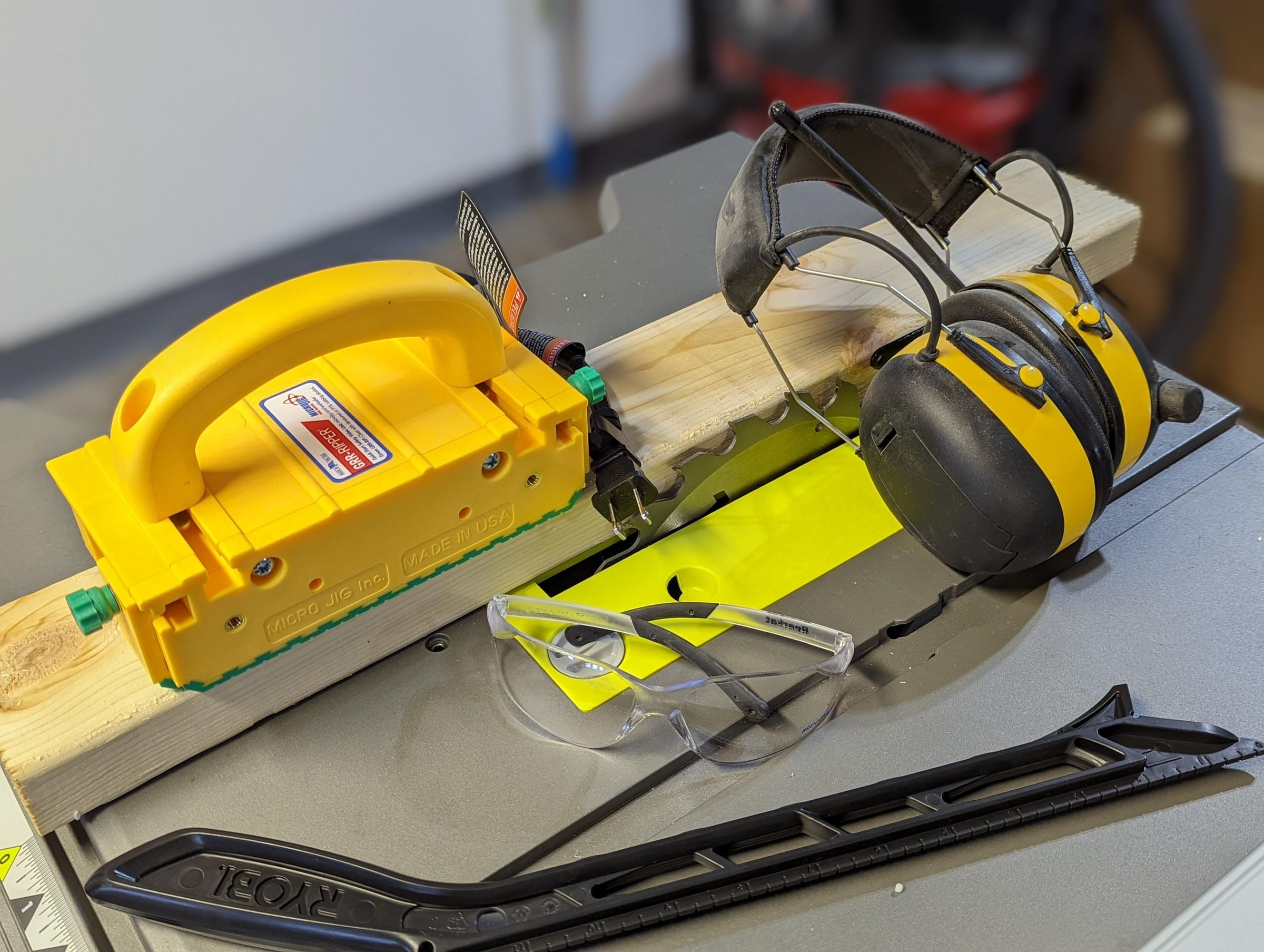

Table saw safety
Always use the correct safety equipment while operating your table saw.
Before we go any further, it is vitally important to cover some safety considerations that will help us avoid injuries while using the table saw. Table saws are very useful and versatile woodworking tools, enabling us to perform accurate and straight cuts using a variety of techniques. But because a table saw consists of an exposed saw blade pointed up at our vulnerable fingers, safety is extremely important. There are three broad areas of safety considerations we need to keep in mind each and every time we use the table saw:
- Hearing and eye protection
- Safety devices and techniques used to reduce the chance of kickback
- Safety equipment and techniques to avoid our hands making contact with the table saw blade
The first of these areas is fairly straightforward. As is standard while using any woodworking power tool, you should always wear hearing protection and safety glasses while operating the table saw.

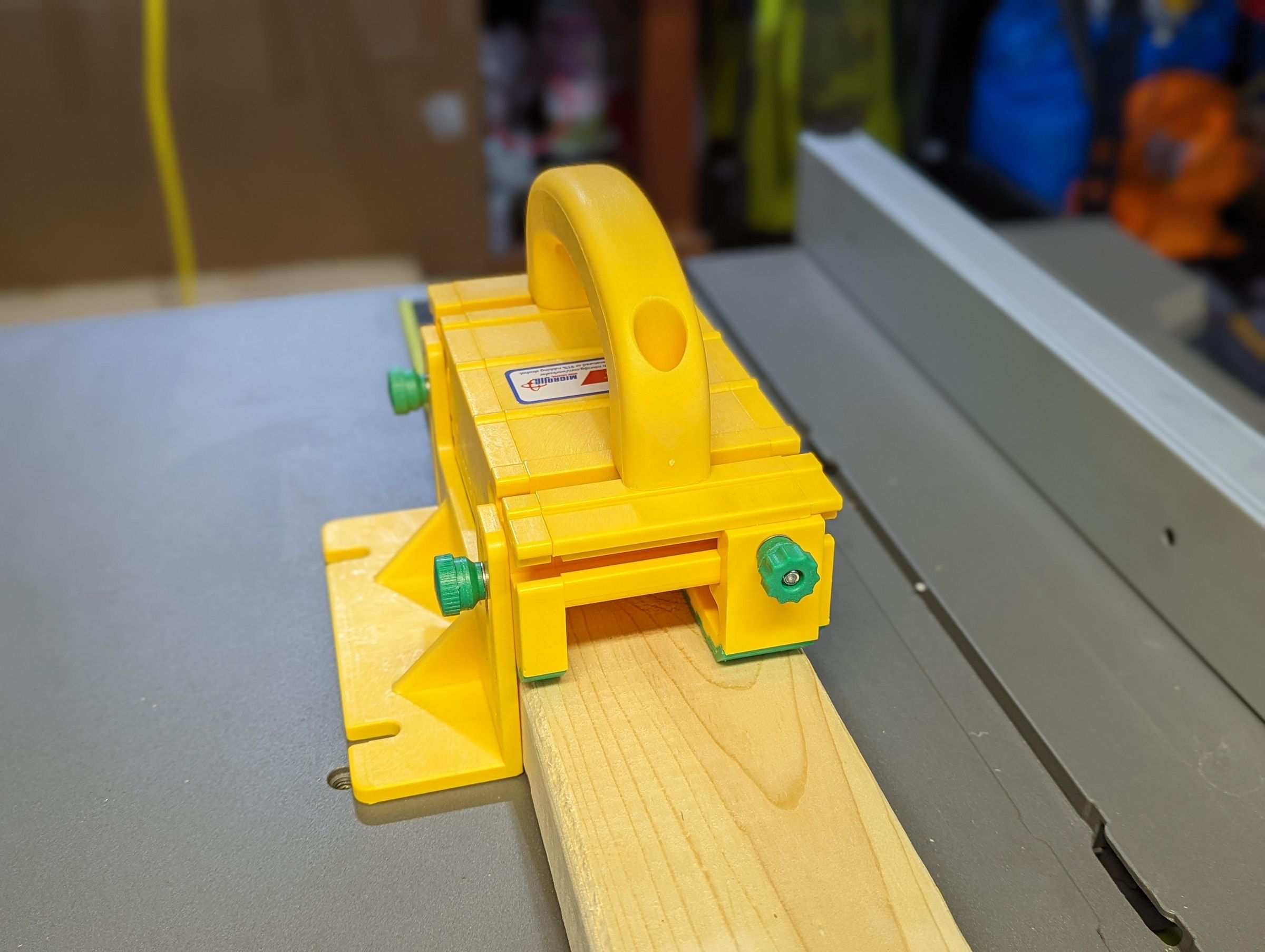

The second category of safety considerations is about a potentially dangerous situation that can occur with table saws or some other types of wood saws, kickback. While using the table saw, keep in mind that the direction in which the table saw is spinning is towards the front of the table saw. So, this means that the saw blade can catch the wood being cut and throw it at high speed towards the front of the tool. This is called kickback and it is very dangerous. There are extensive resources around the internet, not to mention in the user manual for your table saw, concerning kickback and methods to prevent it. A really fast summary is that, to avoid kickback, we must ensure the piece of wood being cut is always kept in tight contact with the table and with the fence. The most common cause of kickback is when the wood is allowed to move away from the fence so that the saw blade catches it at an angle.
So, to avoid kickback, we will always be mindful while cutting that the wood is being held hard down against the table and pushed firmly against the fence. One tool that helps greatly in both of these areas, plus the third area which we will discuss in a moment, is a push block. One of the most popular of these is the Grr-Ripper 3D push block. This tool runs about $60 so it is certainly not cheap, but the cost is well worth avoiding serious injury while using the table saw.
This is a Grr-Ripper table saw push block.
Another important safety feature with which your table saw should be equipped to prevent kickback is a riving knife. This is the metal fin behind the saw blade. This piece of metal slides into the cut piece of wood, between the two pieces behind the saw, to prevent the wood from pinching back in on the blade from behind.
The final area of safety considerations is making sure your hands do not come into contact with the blade. This is another area where using a push block improves safety. The push block keeps our hands farther away from the saw and out of the path of kickback at the same time. However, besides using equipment to prevent a very nasty encounter between a finger and the table saw, one of the most important ways we can prevent injury here is to always be mindful of the position of your hands and the saw blade. Be careful not to accidentally contact the blade while picking up items around the saw, reaching for things on the other side of the fence, putting down your push block, or other activities. Just always keep your hands as far away from the blade as you can while still ensuring good control over the workpiece.
And the final important safety step that bridges all the areas above is to always ensure the table saw is unplugged before performing any adjustments or maintenance. Before moving the blade or adjusting the riving knife or moving the fence, or performing any other actions, make sure to unplug the saw. This adds a couple extra seconds to your woodworking project but, again, it is well worth saving your hands from injury.

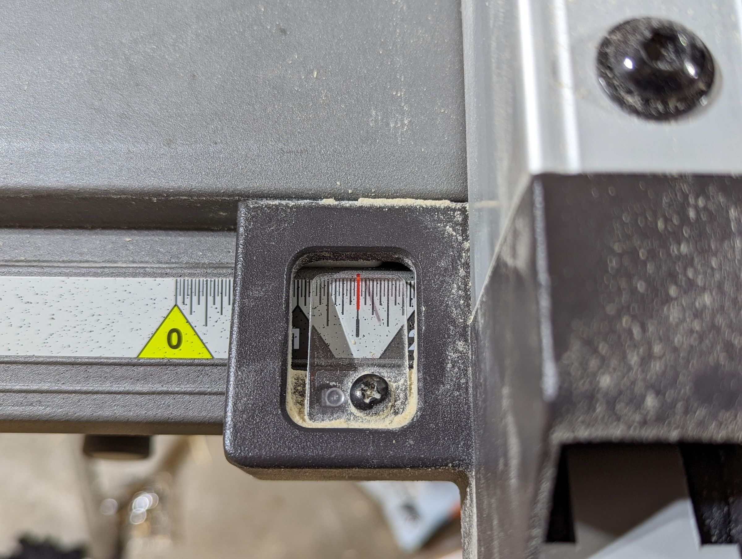

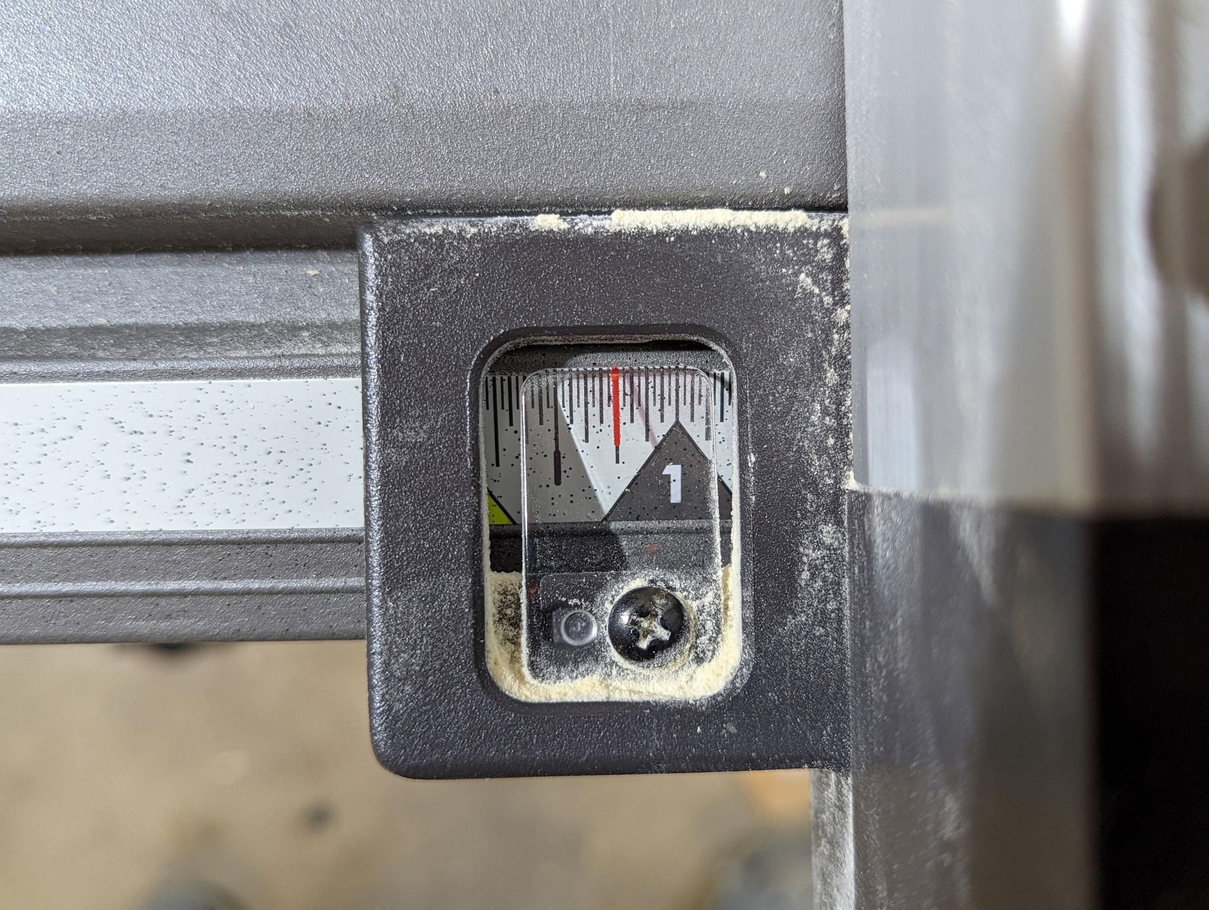

Then we need to adjust the fence. Most table saws will come with a ruler on the front of the table allowing us to read the position of the fence (the spacing between the fence and the blade). For work requiring high precision, it might not always be the best idea to rely on this ruler, but for our purposes, it will not impact the project in any meaningful way if the measurement is not exactly 1.5 inches. So, move your table saw fence until it is 1.5 inches from the blade.
For this project, the ruler built into the table saw will be accurate enough.

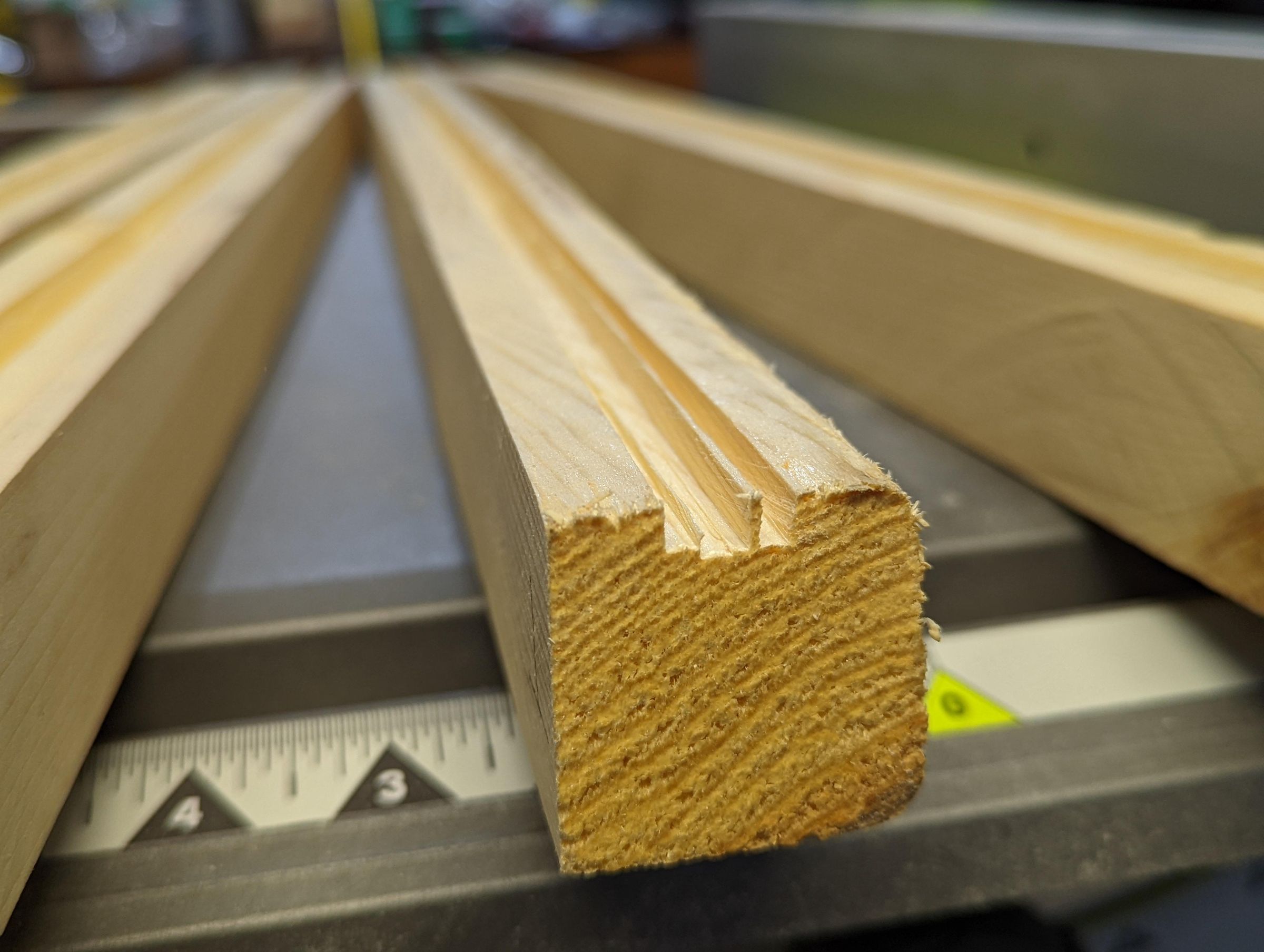

Make dado cuts to hold the canvas art
The first step to making the dado cuts that will allow the canvas to be held into the frame is setting the height of the table saw blade. Before doing anything else, make sure to unplug the saw for safety. For this operation, the blade height should be set to about 1/4”. This will result in a dado cut that is deep enough to securely hold the canvas without obscuring too much of the artwork. While you are setting the blade height, you should also make sure to lower the riving knife.
We will make the dado cuts about 1/4 inch deep.

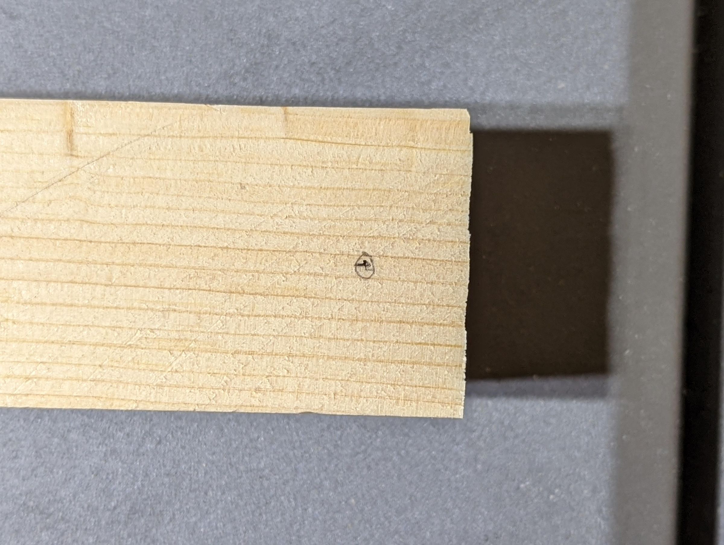

The next step that I would recommend completing is figuring out which side of the boards will be the front-facing side of the frame. This will help make sure you put the best looking side forward and also help to keep track of which side the dado cut needs to be on. Arrange your boards on the floor in a square and place a small T on the ends of the boards to designate the top side. We will be cutting off both ends of each board in an upcoming step so if you place these letters on the ends of the boards, we will cut it off and you don’t need to worry about erasing it or sanding it off.
To keep track of which side of each board will be up, write a T on the designated top sides.

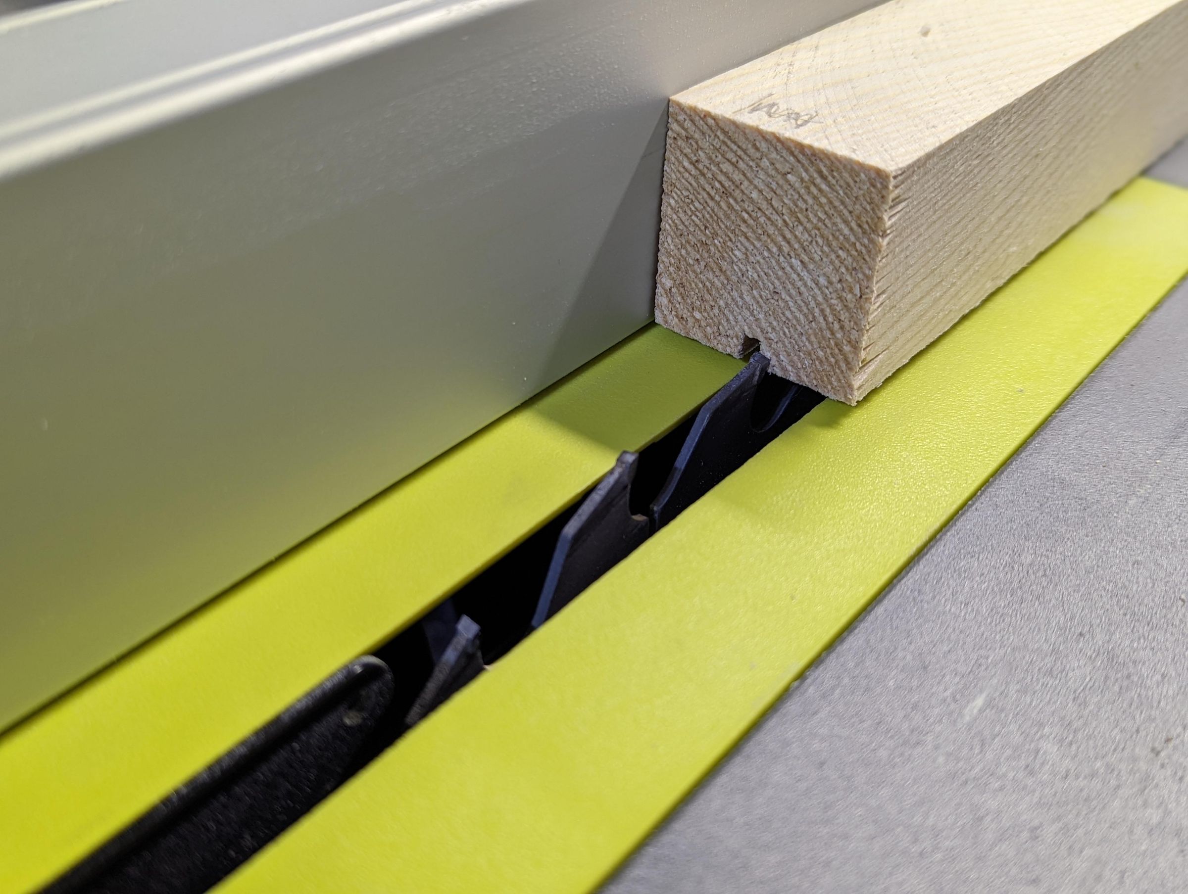

Next we need to set the fence position. We will end up making several overlapping dado cuts in order to make a channel wide enough to hold the canvas. The first of these cuts will be in the center of the board. So set the fence to the ¾ inch position.
And now it is time to cut. So be sure to put your protective equipment back on if you took it off and plug the saw back in. To ensure we get the most consistent results, we will work in an assembly line process for this step. Take each of the boards out of their square arrangement and position them to make the first dado cut on the side that will be the inside of the frame. Then, just like we did with the rip cut, pass each board over the blade in a smooth motion.
Next we will adjust the fence position to make another cut that overlaps the first one. This will have the effect of making the dado cut wider. So, move the fence about 1/16” away from the blade.
To make the wide dado cut, we will make a series of overlapping dados.
Then, with each board, make another dado cut just like the one you did in the middle of the boards. This time though, after making each cut, turn the board around 180° and run it over the blade again. This allows us to expand the dado cut by ⅛” even though we only moved the fence by 1/16”. It will also help to make sure the dado cut is as smooth as possible.
Repeat this process about two more times, or until the total width of the dado cut is a little bigger than the width of your canvas. The best way to test the fit here is by testing it against the canvas itself rather than just by measuring.

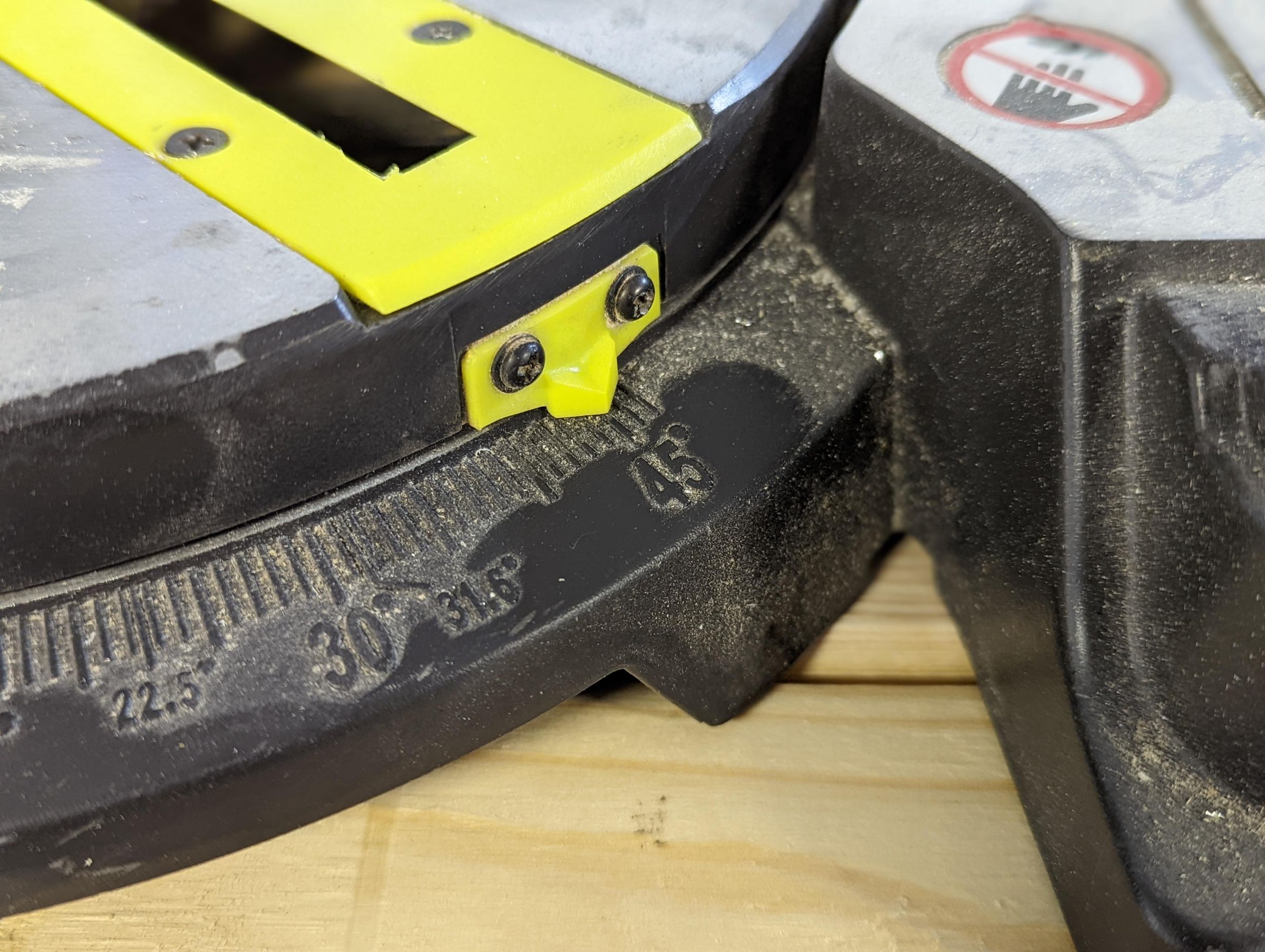

For this step we are going to switch out the table saw for a miter saw because we need to make the 45° cuts for the corners of the frame that will also cut the sides of the frame to length. So, the first step is to set the miter saw to 45°. It is important that this angle is as close as possible to 45° or else the corners of the frame will have gaps. Therefore, it is advisable to use an angle measurement tool to make sure the cut will be as close as possible to exactly 45°.
Set your miter saw to 45° and double check this angle to make sure it is as accurate as possible.

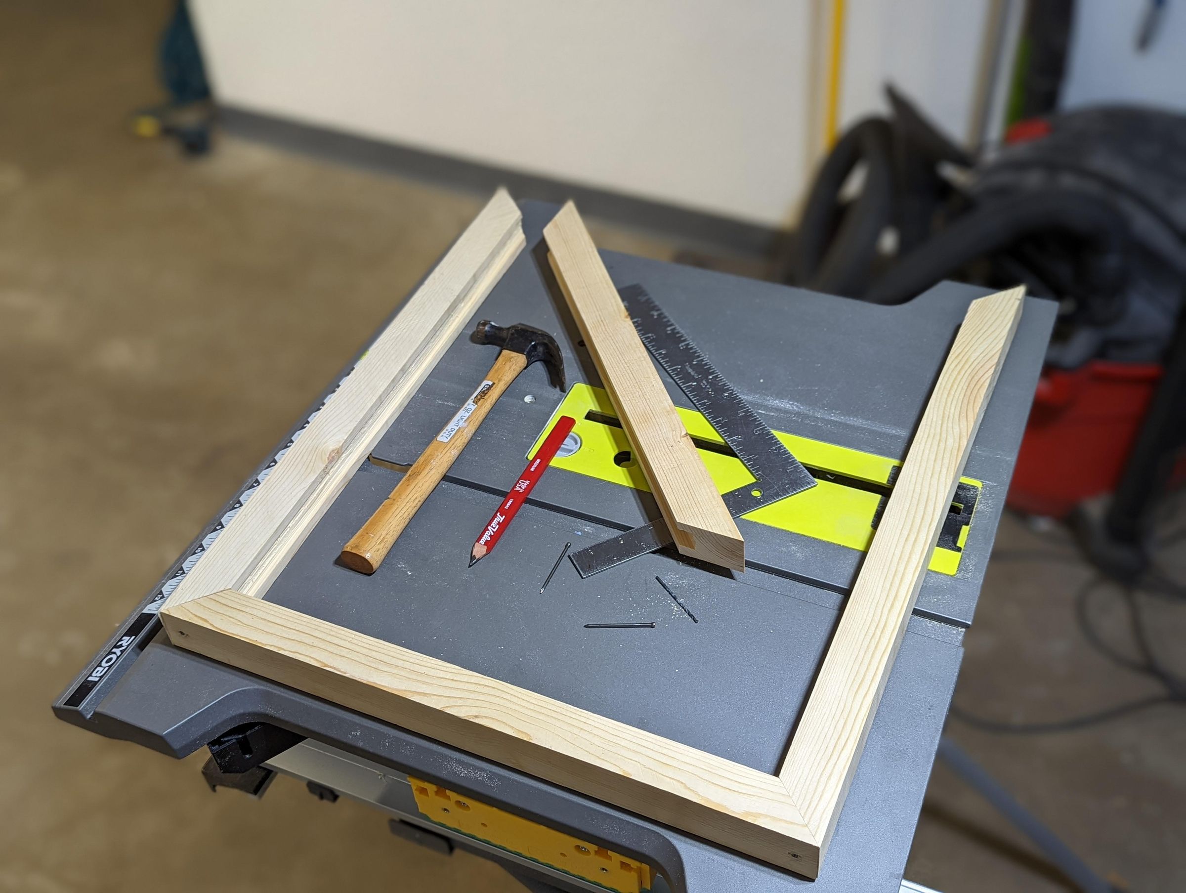

Step 4: Drill Pilot Holes for Nails
There are a number of ways we could fasten the frame together. Because I wanted my frame to be reusable, in case I want to switch out the canvas at some point, I decided to fasten the corners together with nails that could be removed later on.
First, select a drill bit that is just a bit smaller than the nail. This will be used to drill the pilot holes. Select a second drill bit that is just a bit wider than the head of the nails. This will be used to countersink the nail heads so they do not stick out of the frame.
As for the placement of the nails, I would recommend putting the nails into the top and bottom of the frame rather than the sides. The nails will be a bit less visible on the parts of the frame that people see less. Measure ¾ inch from the end of each side of the picture frame and place a mark exactly in the center of the board.
Clamp the corners of the frame together so their alignment does not shift while you are drilling the pilot hole. Once the mitered joints are clamped together, drill a pilot hole at least as long as the nails.
Then, using the larger drill bit, countersink the pilot holes just deep enough to hide the nail heads.
Finally, attach three pieces of the frame together to make a "U" shape into which we can place the canvas shortly.
